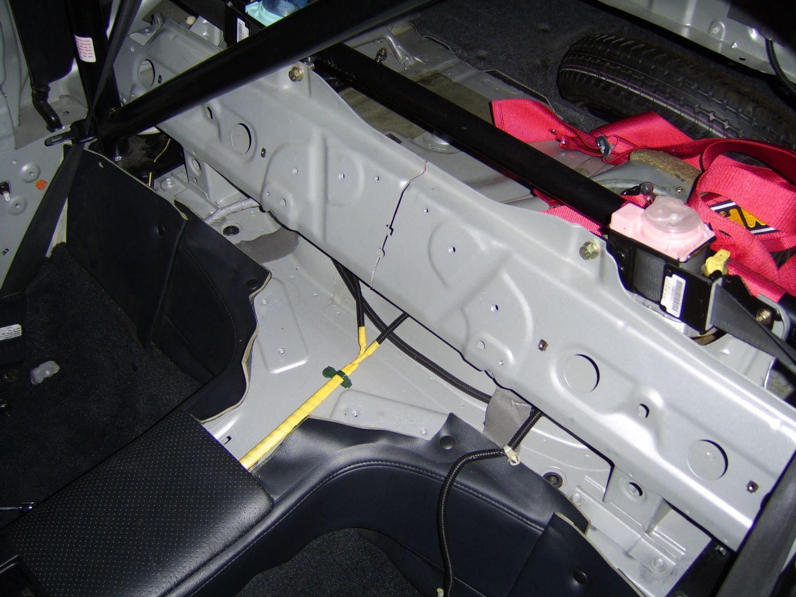

^It's funny that you were the first to reply because I was actually going to pm you at some point and ask for pics of what you did to the bulkhead. I had remembered reading that you cut it in half for this very same reason.
Only concern I have is that bulkhead probably isn't bolted down well enough without also having the factory rollhoop bolted in as well to use the oem belts. Right now I don't have the factory hoops in and don't plan on it either but I don't really want to pull them apart either to get the metal hoop out.

Yeah, its easier to get on track here.
But, you can still add the factory roll hoop like I did.
I wanted it to attach to the car also for the proper support. This thing doesnt move with the way I have it.
