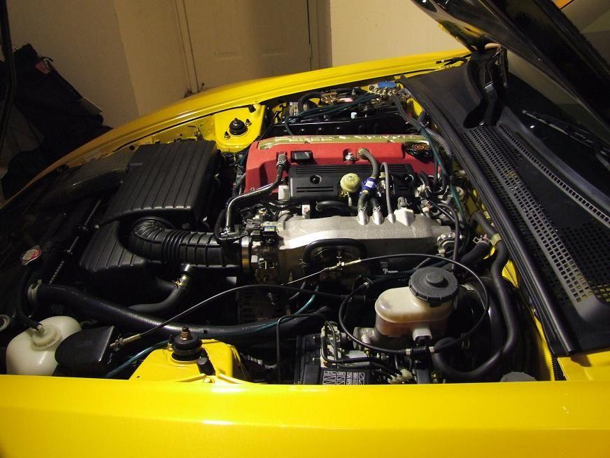

1/4 of a can added to the oil approx 100mils befor the change (added when oil is cold through the dip stick)

seafoam in the gas helps clean fuel pump/fuel lines, injectors and a bit of the cylinder walls.
seafoam in the oil helps clean the gunk from everything that is lubed by oil.
Seafoam in the manifold is to really clean the manifold (due to PVC gunk) and clean the intake valves and a little bit of the exhaust valves and the cat.
Get rid of that catch can and get one of these from Wal-Mart or Lowes it works better and its only $12

I add seafoam to my oil hence the oil change I am not really sure how seafoam effect the oil properties hence I only leave it in for a very short time.
The bottle says that you can leave it in the oil in for an entire oil interval.
If you are only adding the seafoam thought the manifold or in the gas an oil change is not necessary

^ Looks like an air/oil seperator for an air compressor
