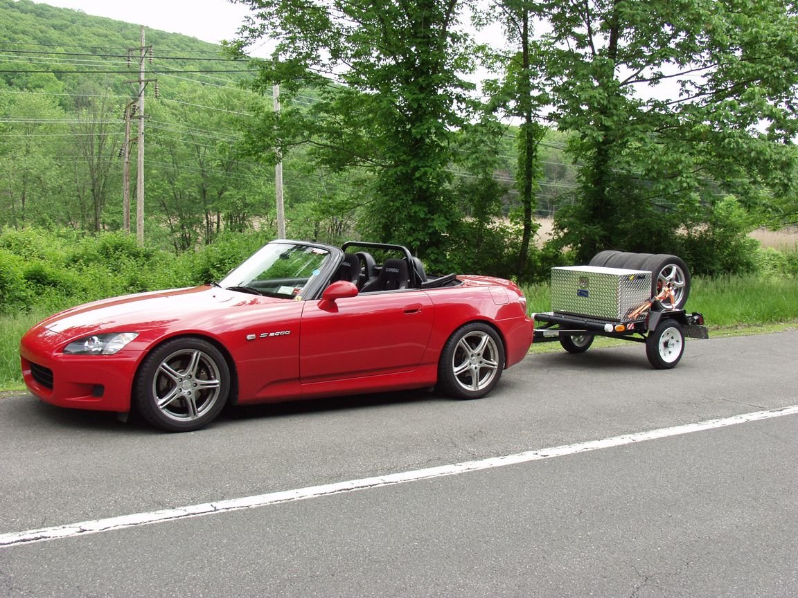

Originally Posted by CoralDoc,Jul 14 2004, 07:06 AM
The FAQ I wrote on trailer construction, hitch installation and trailer wiring is gone again. hopefully it will be reinstated as I put a lot of effort into it and many people have found it to be helpful.
Including me! Thanks Doc!!
This is the 832TA from the link in my previous post.
J-
