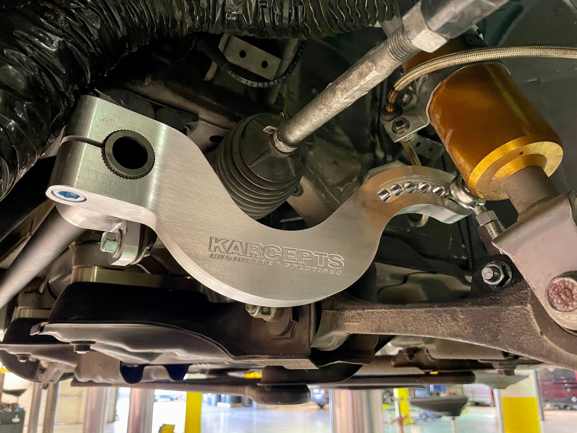

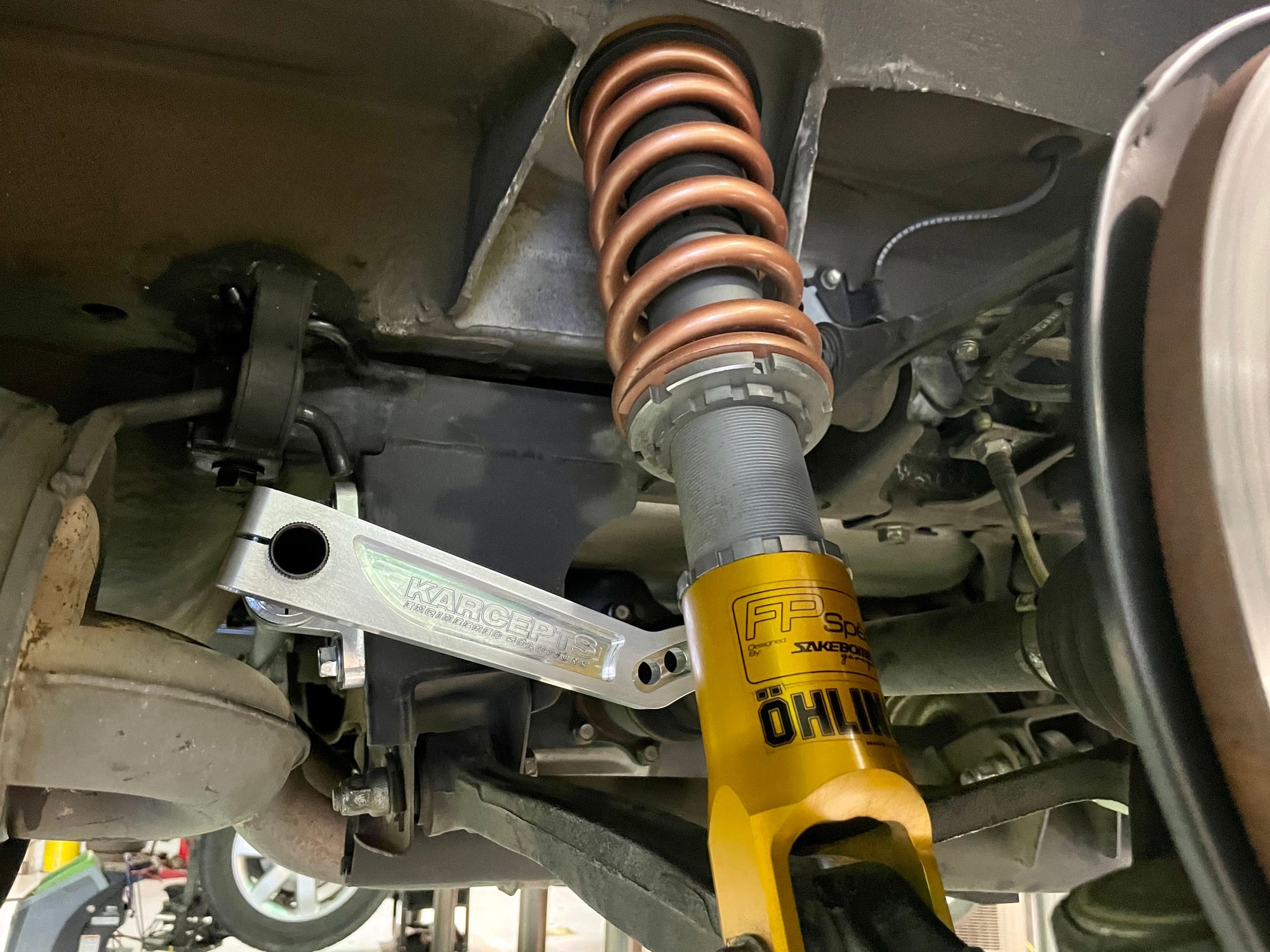

Got .250 front and the rear bars. Installed a few days ago. Next track day is this weekend so I will have a chance to see how the car handles. Set to softest setting upfront and middle in rear.
Thanks for the feedback everyone. Helpful.
