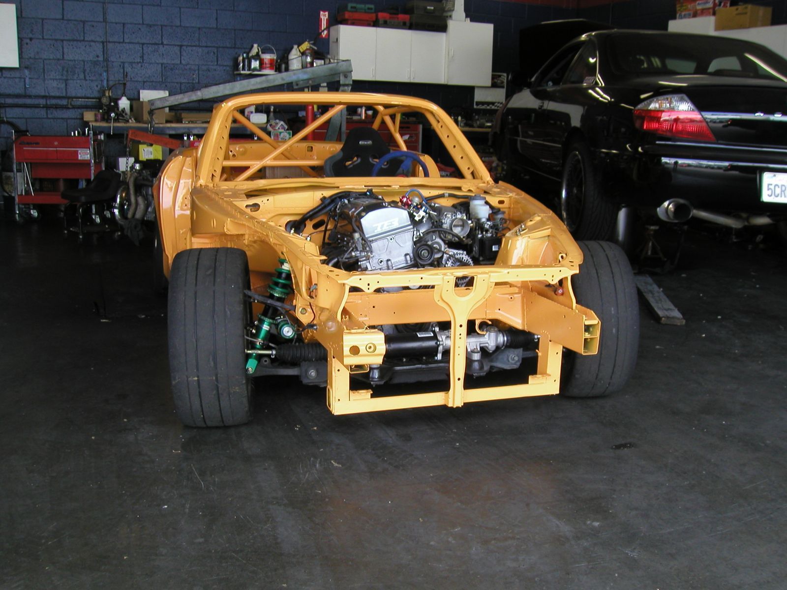

So there is a metal protrusion that sticks out about 2" from the inner sheet metal wall at the top of the front fender well. I seem to be rubbing there pretty bad, and it's keeping me from lowering the car.
Has anyone else with the huge rubber found this?
My thought is to cut it out and tig weld in a piece for strength. I'm only rubbing on the outside edge of the thing.
Thoughts?
