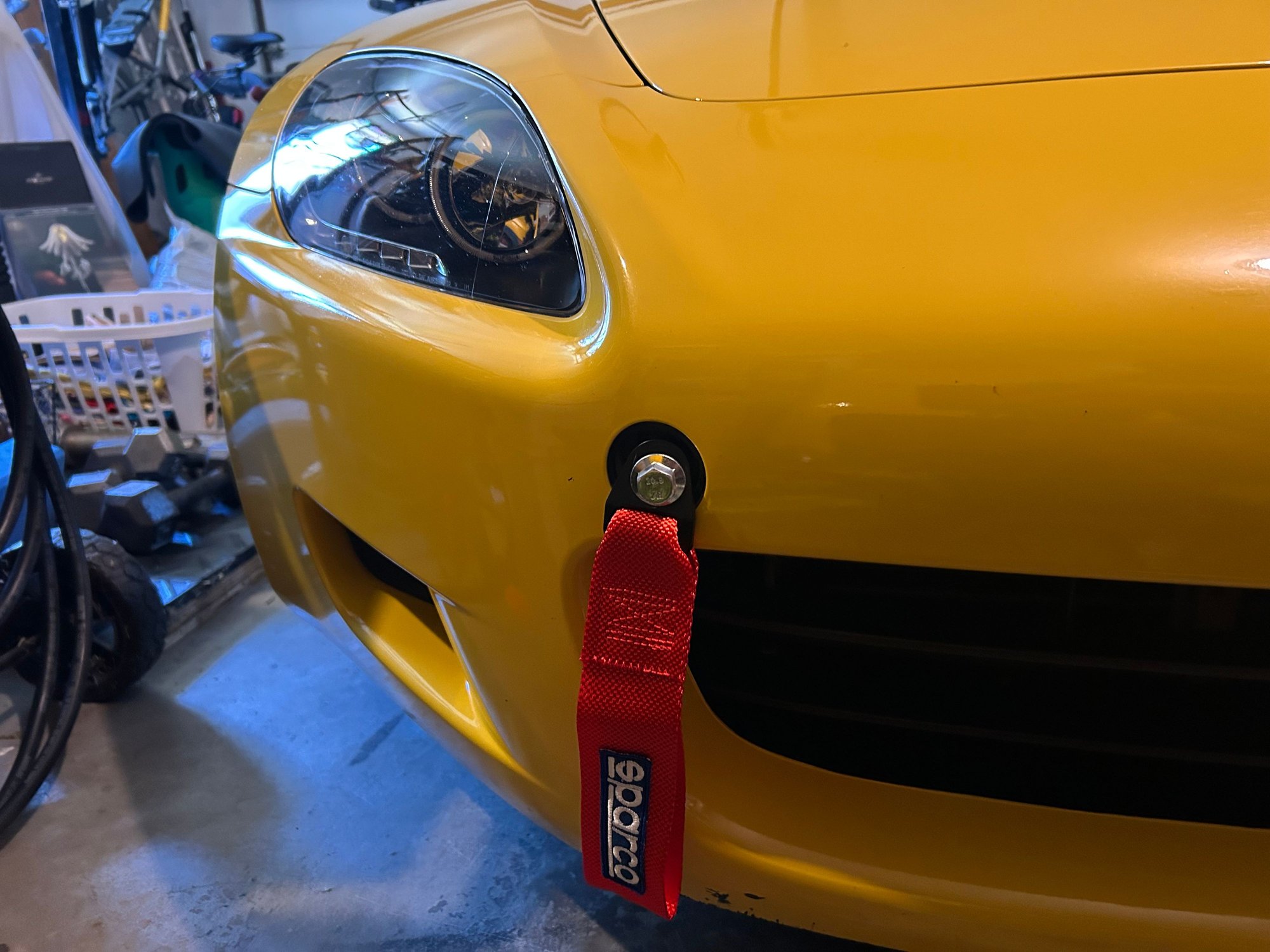

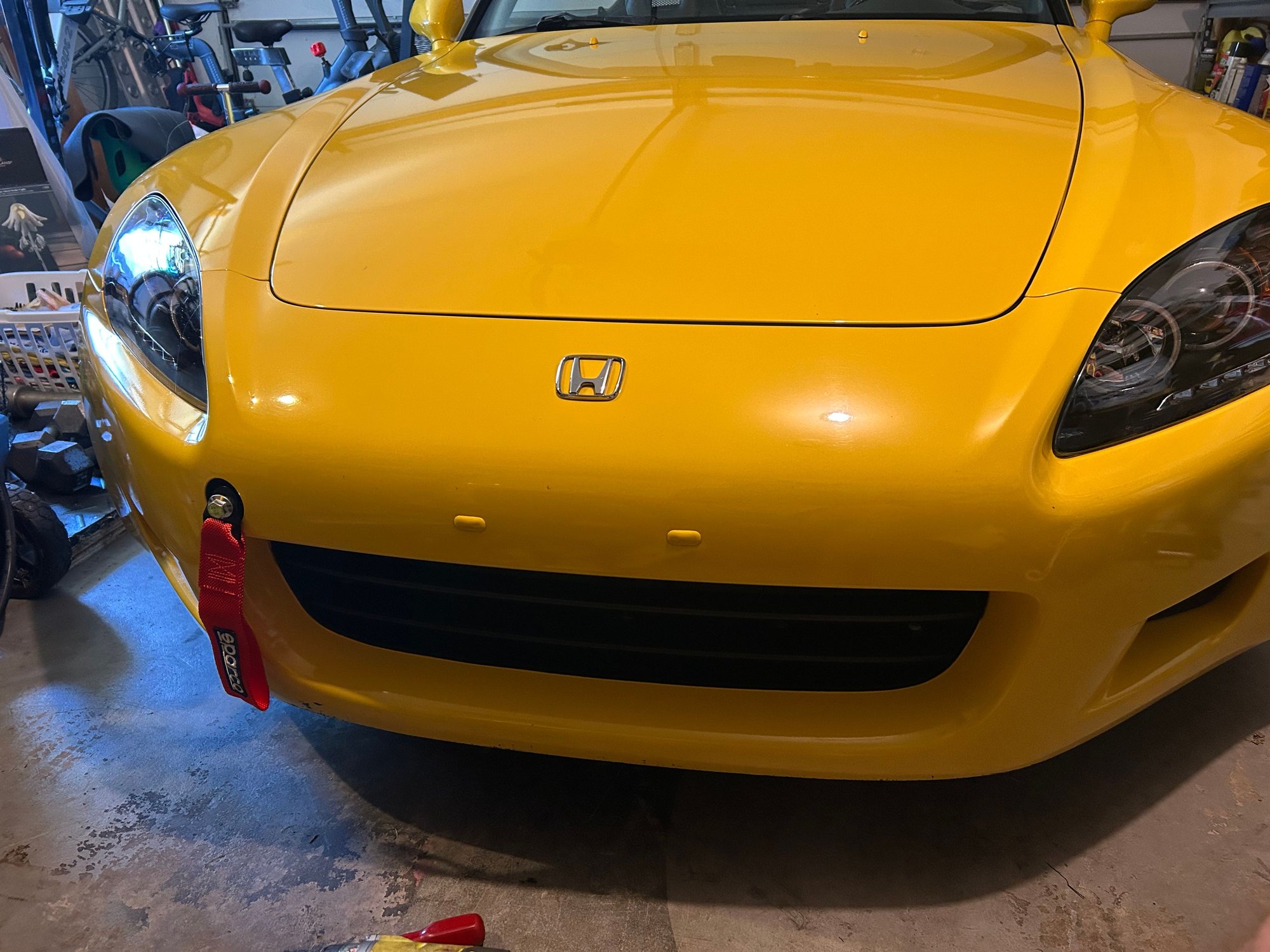

Originally Posted by DanielB
On my MY00 the threads start about 1" (going from memory) behind the bumper cover. I use the eBay hook because it's simple to remove the bumper cover plug and screw the hook in for each track day. I'm having a hard time visualizing how to do that with a strap. Any pictures?
I got to admit, I don’t love this
It’s fine but loaded looks terrible, I could see it breaking. I’m going to keep messing with it
It sits fine but loaded looks terrible, I could see it breaking. I’m going to keep messing with it
