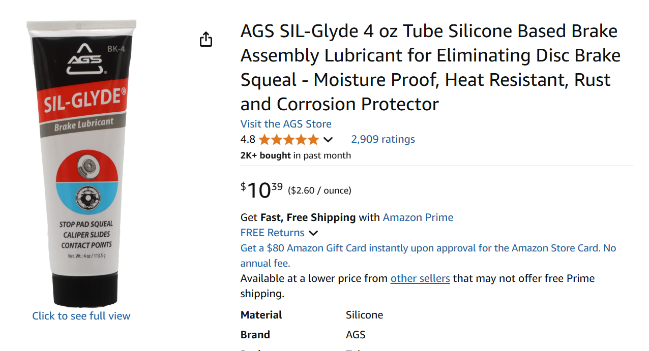

I was running orange high temp permatex for years and years.
When hanging out at the track with the german car guys last year, they mentioned using Sil-Glyde. Everyone in spec e30, spec3, spec46 uses this stuff on their oem calipers with great results.
I switched over this year and noticed that it holds up better than the previous stuff I was using. Its cheap too!. I usually grease pins once every 4-6 track days. I was going to the track almost twice a month and really abusing the oem system. This stuff works.
