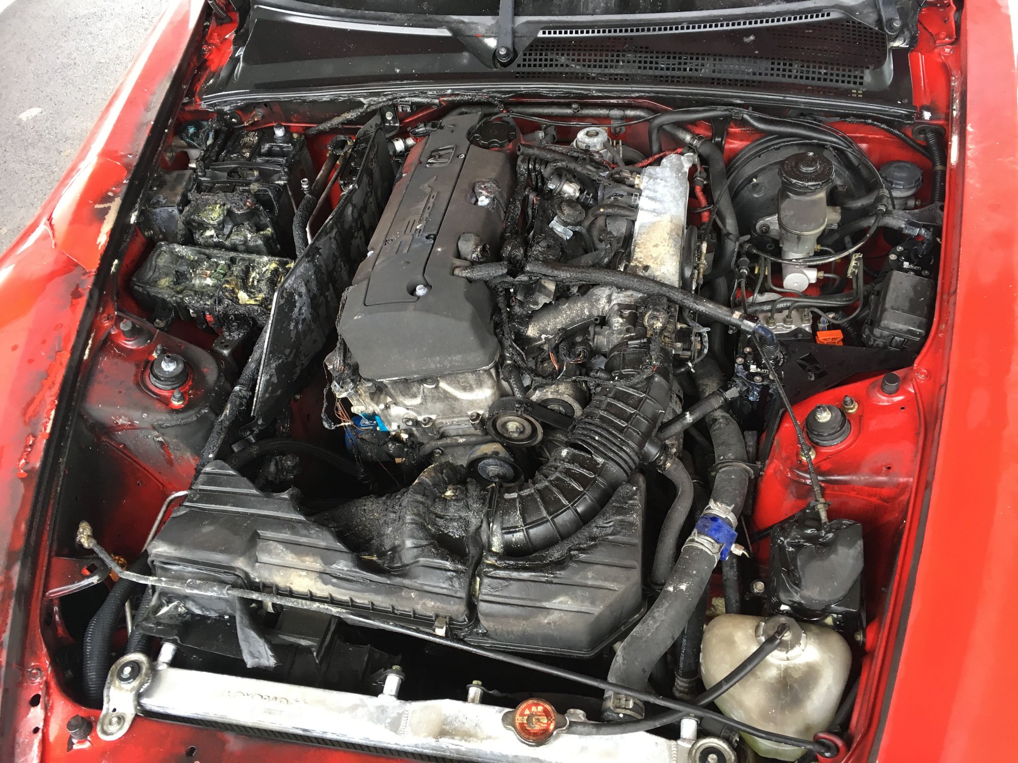

Money shifted turn 1 at COTA, 5-2 shift, exploded diff in big chunks. A car I just rebuilt had oil filter spin back off oil cooler kit, sprayed engine bay in oil and burned engine bay badly. It's since been rebuilt.
And yet another testament of NOT hand tightening the filter on these cars!! That looksl like it could have been much worse! How did the rest of the car fare?
