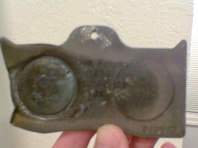

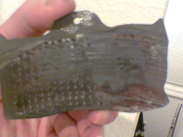

Run 'em till there's no more pad left, just don't go much farther than that. Normally I only go through a 1/2 a set of fronts per track day, but I went a little over--and then some last time I ran at Thunderhill:
Outside pad looked like it had about 2mm left, but the inside pad was worn down to the backing plate, plus some. Though it made no sound on the track, the pad squealed like a wounded banshee when I was tooling home in traffic after the day was over and the brakes had cooled down. I pulled off the hwy to inspect and was pretty shocked to see what I saw. Fortunately had a misc. pad with a few miles left in it that I wedged in its place. I do believe I came pretty close to popping a piston out.

i think you run a higher risk of cracking the rotors when you get down too low as well.? I cracked 2 rotors when using nearly worn out pads

I say it'd be a good idea to change out the pads with 5mm left. I tried skimping on my pads on my last track event and the fronts wore down to the backing plate and i didn't bring an extra set of pads to change out. Needless to say, i drove back home using my e-brake to stop. Also, my driver side rotor is now scored from the backing plate.
