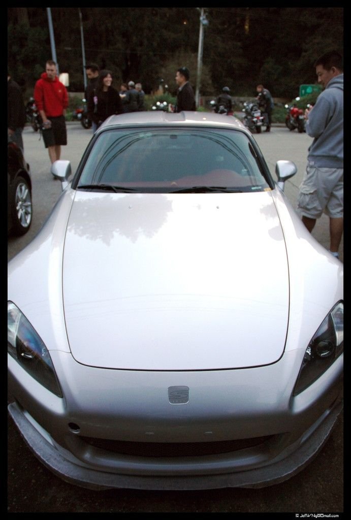

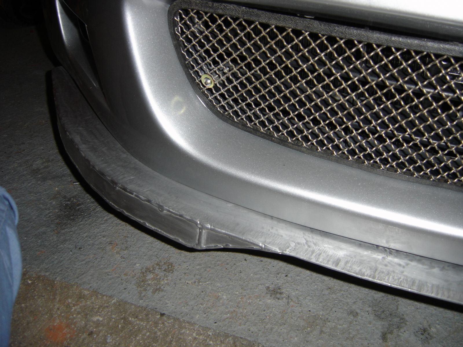

Originally Posted by msm_s2k,May 4 2006, 01:39 PM
What side skirts and front splitter are people running?
I made my own.
I call it a skid plate since I get lots of shit when I tell it creates downforce. I guess you can call it a splitter in a generic sense but my intent is not to restrict air under the front end but to accelerate and drop localized pressure.
the front section converge and then flattens out a quarter and then tapers back up at approx. 4deg to avoid flow seperation with too steep of a gradient. pretty much, it's a generic shape of a typical wing section.
engine cooling becomes an issue so the car is running an oil cooler now.
it sits 4inches off the ground with stock susp.
