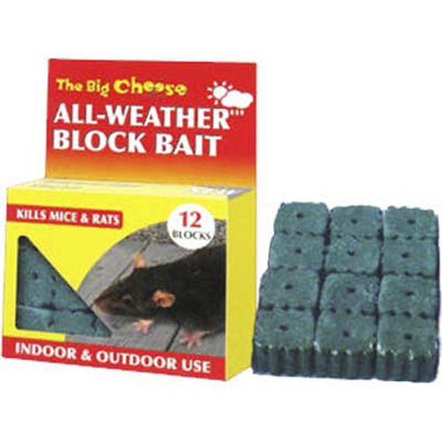

Place bait blocks along the walls of the storage unit. Nail them to a small piece of wood. Make sure there is no food or water source in the storage unit.
