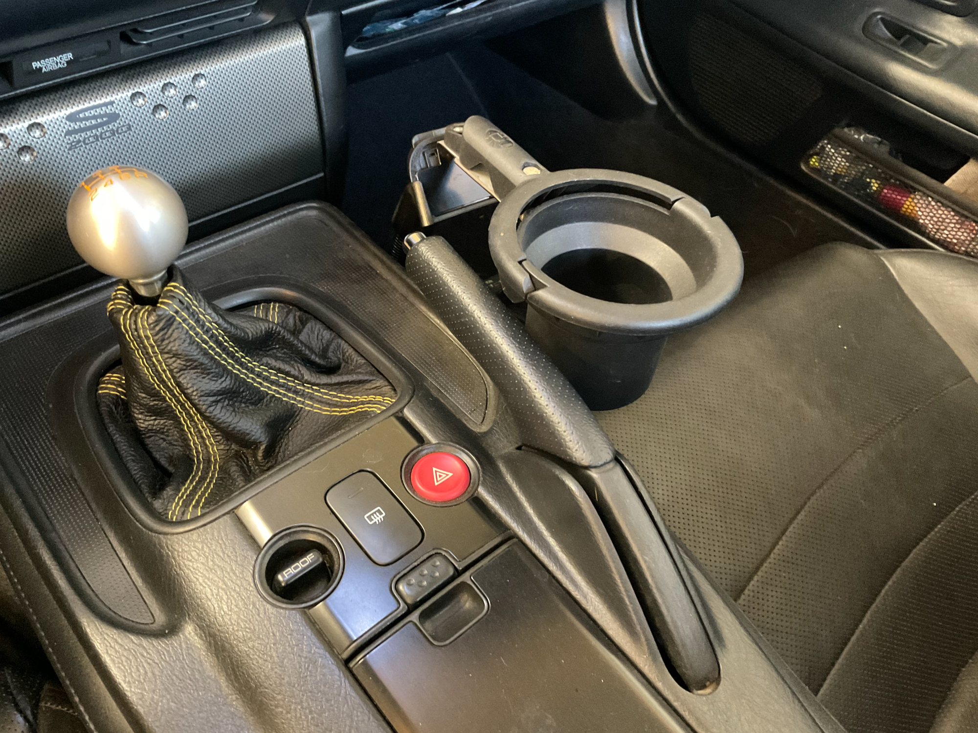

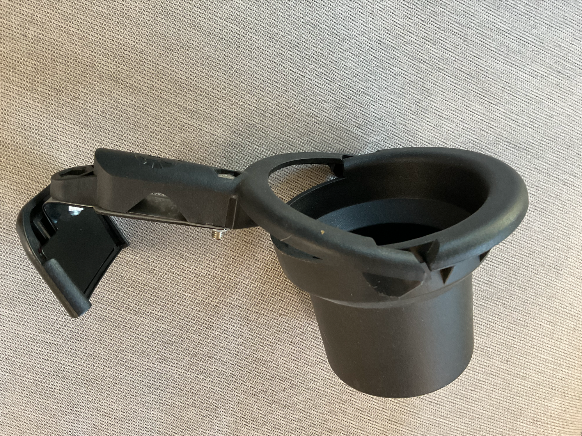

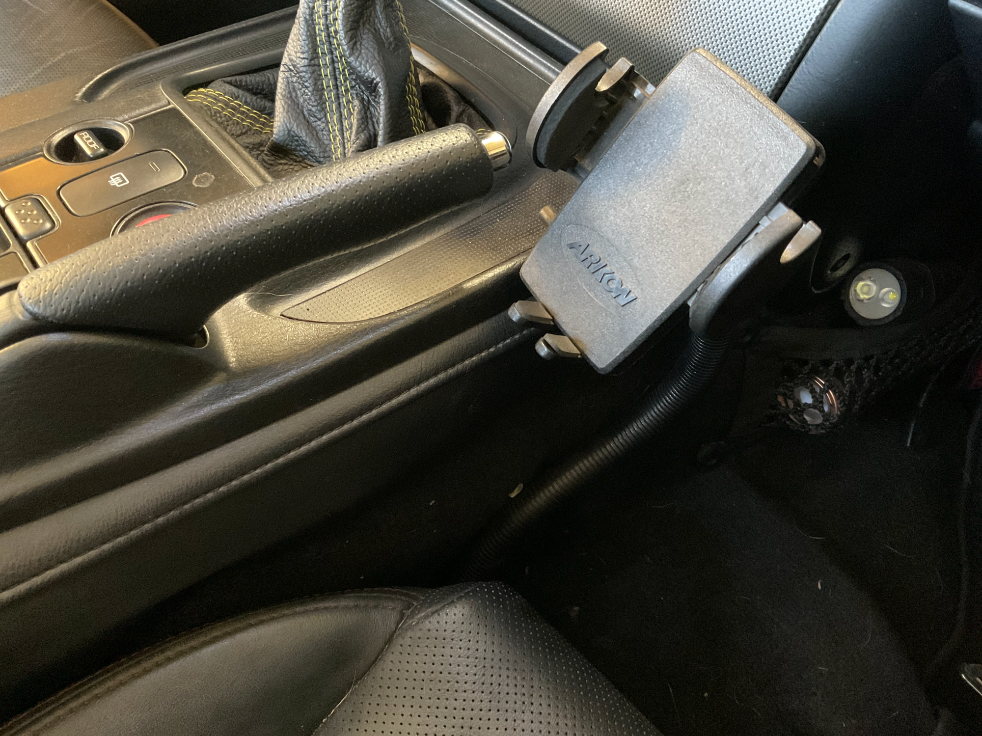

Cup holder? What cup holder? I have no idea where my cupholder is on my 2009 AP2. That little flip up lever in the console compartment I thought would be for a phone holder. It cannot hold any kind of a cup. I tried it once and learned the hard way. I have a holder that fits the universal T mount on a stalk mounted to the pax seat that also (mostly) is used for my phone.
Valve adjustment for DBW is well covered but I have found that once I performed the first valve adjustment around 40K miles, the second look/see at 65K miles revealed no appreciable change. After the first one (if done correctly) you are good to go.
I am including some pics of the "revised" cup holder for a minor hijack of the thread.

I might be the only one who doesnt mind the AP2 cup holders. I only use it for disposable water bottles and it works just fine. Perfect for those squarish Fiji water bottles also. Maybe not so much for oddly shaped or top heavy cups. I would be nervous to use for anything without a cap. Love how it is a soft open and clean look when you close it. I’m a fan!
