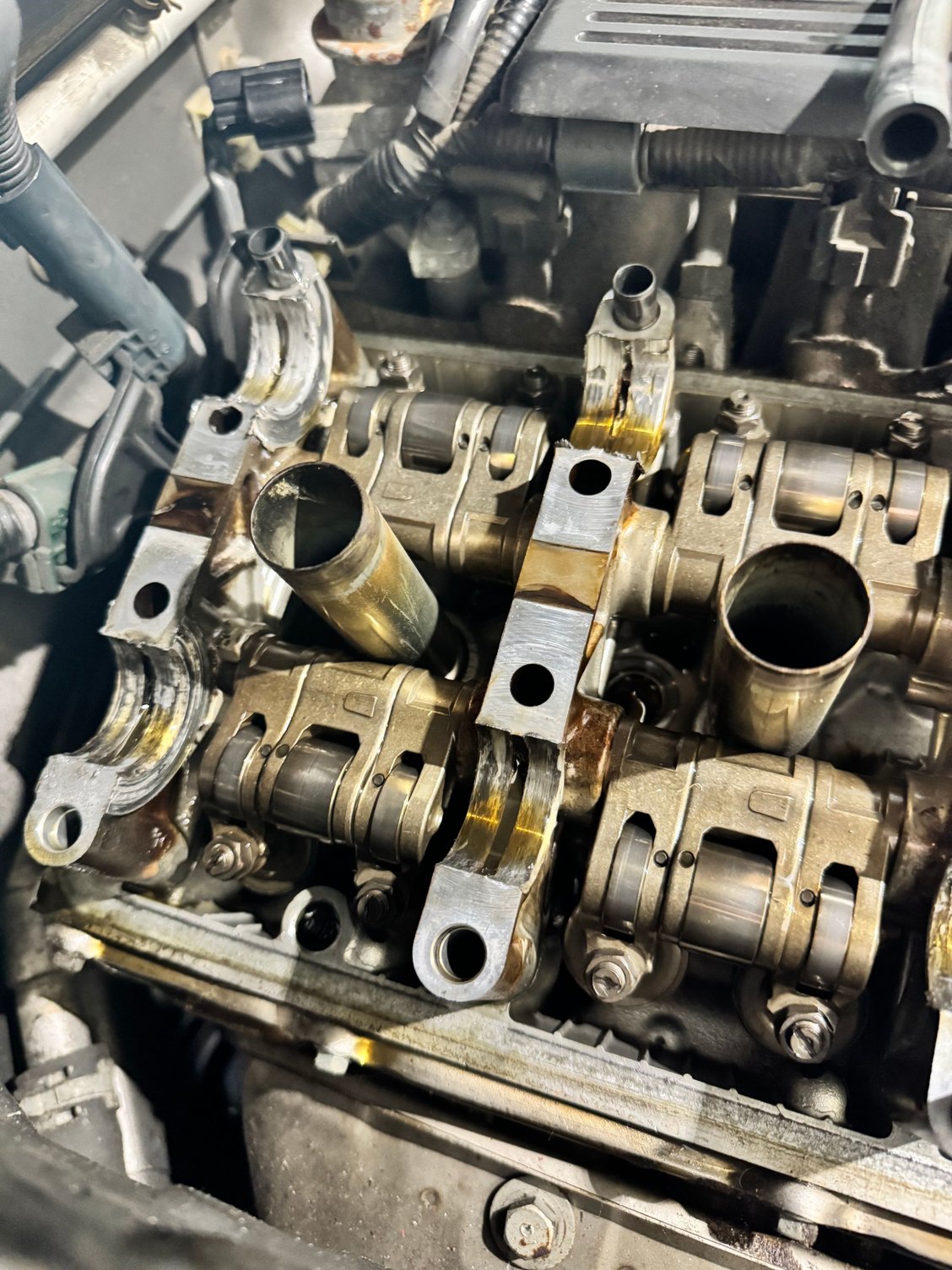

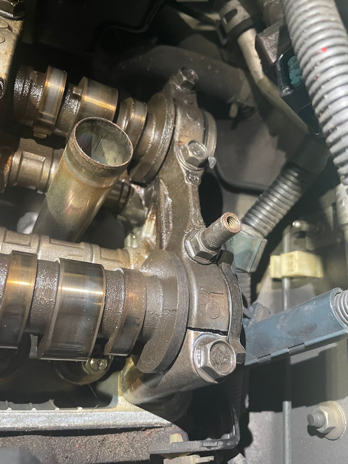

Default Cam Caps Broken!
Cam cap 5 broken. That was the reason sensor was worn.

That was a good guess

Sure was! Thank you for the input. Any suggestions from here? Full set of the cam caps? Anything else I should do/look for while I’m at it?

oil pump will prolly be shagged,cut oil filter open and dare say it need strip down and rebuild due to alloy everywhere in oil ways inc crank ect a grim sight.
Problem is finding a shop to do this with good results....
