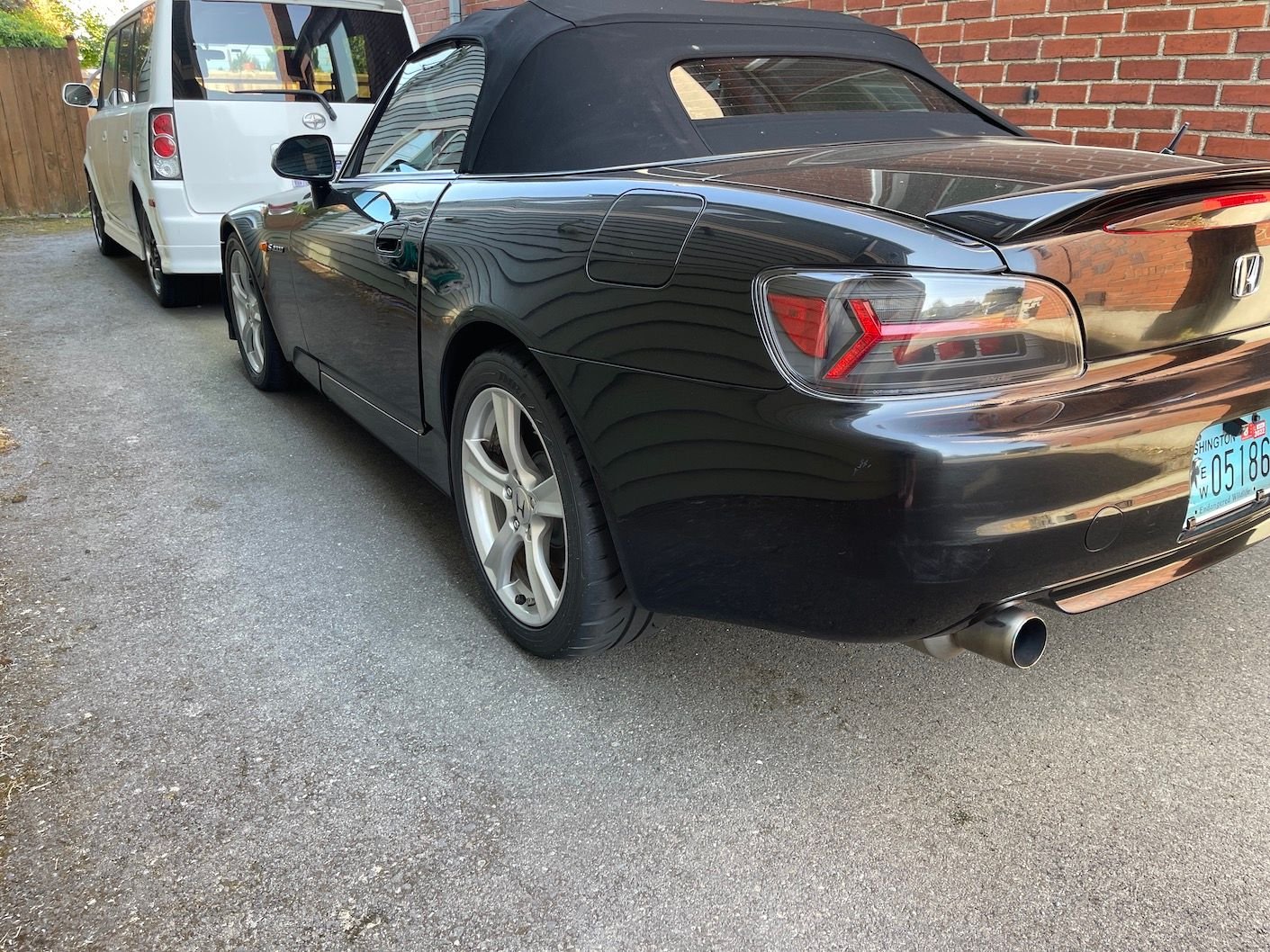

I have a 2002 AP1, and the BEST wheels I found for them are the CR wheels from 2008. I went with silver, not gunmetal, so maybe they were not just for the CR.
It's a 2002 AP1 with NO modifications, and on the CR wheels I have 255/40 17s on the back and 225/45 17 on the front. Dunlop Direzza zIII, and not only do the FIT perfectly, they also LOOK like they were the original design for the car. I always thought the AP1 wheels and tires left too much room in the wheel wells.
Short answer? Do it.
See? Looks like it was always designed for bigger tires and wheels. At least that's my story and I'm sticking to it.
