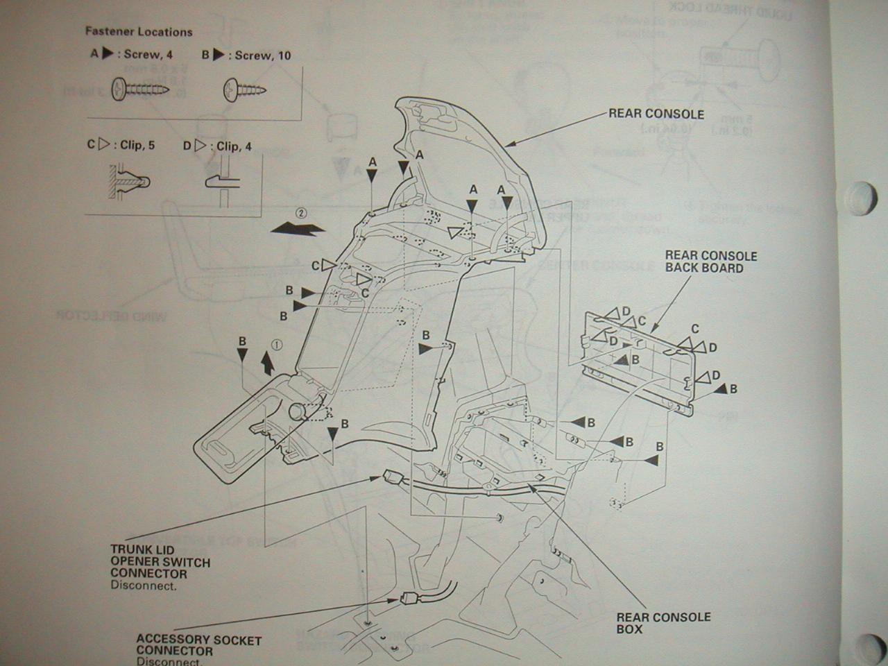

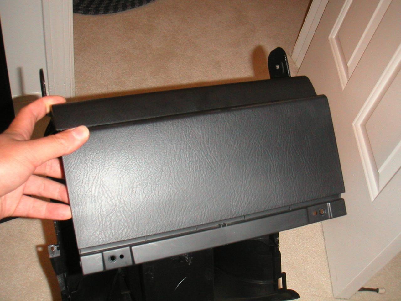

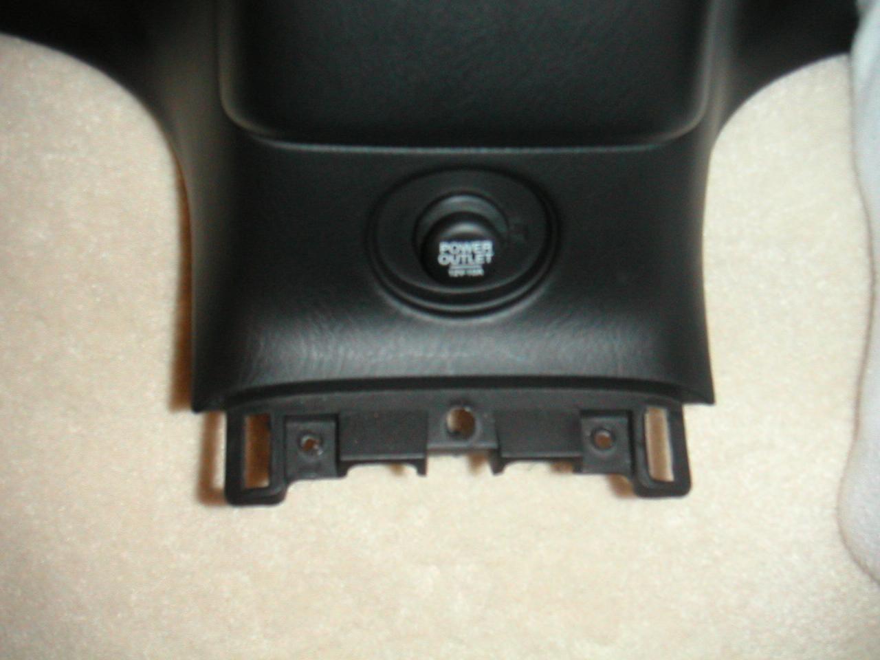

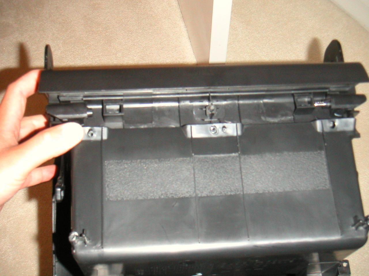

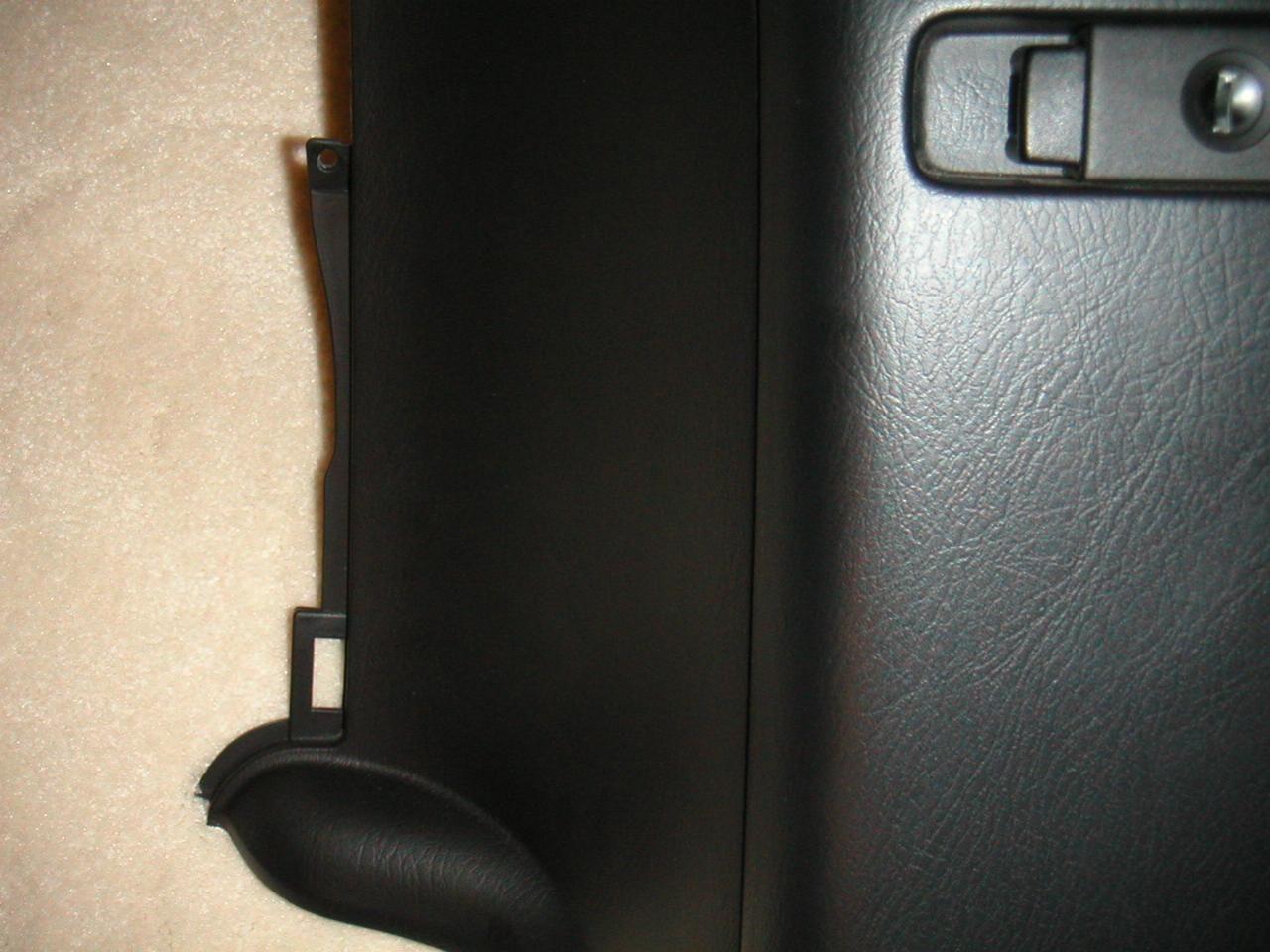

You can double (left mouse) click on each pic and see it in larger (FULL) size (1280 X 960) in detail

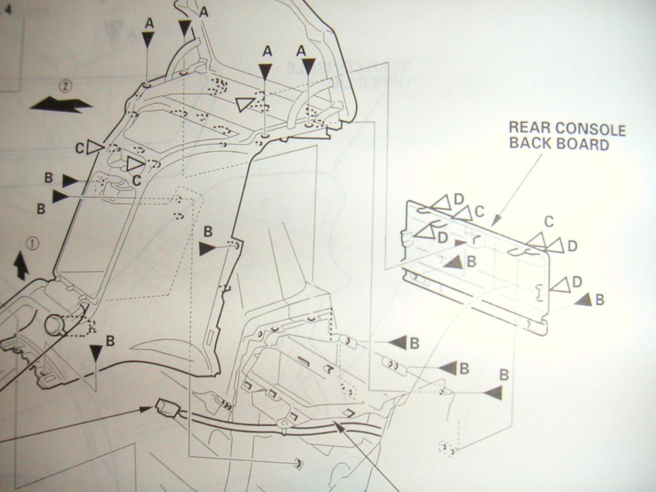

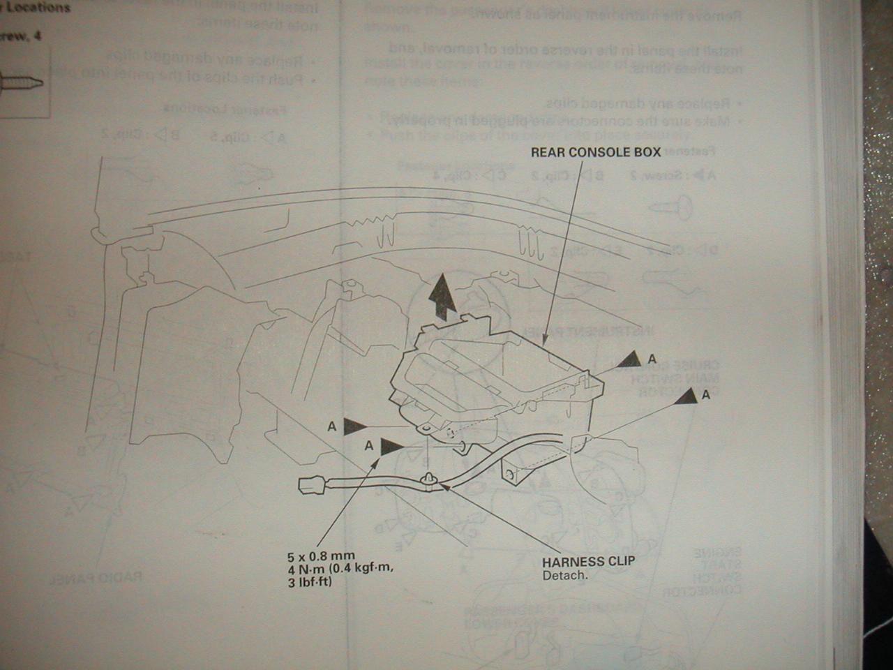

2 screws to remove the rear panel
3 screws to remove from the secret compartment tray

remove 4 screws from the top(under the lid)

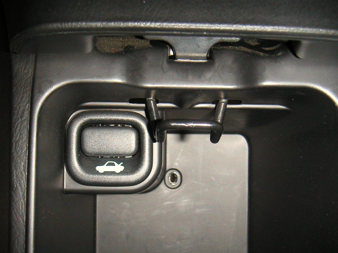

1 screw from the inside of the "Glove" compartment
2 screws on both sides

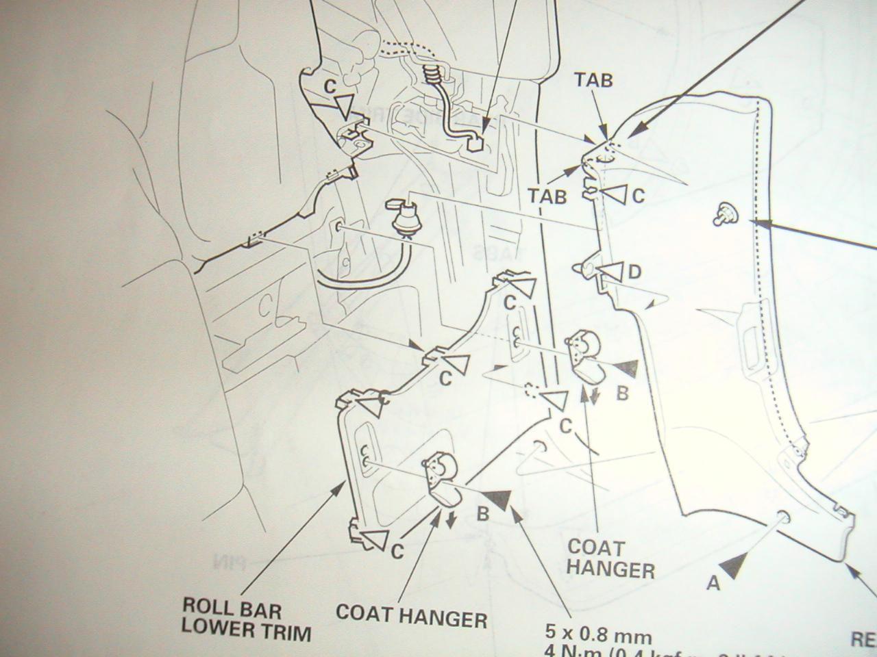

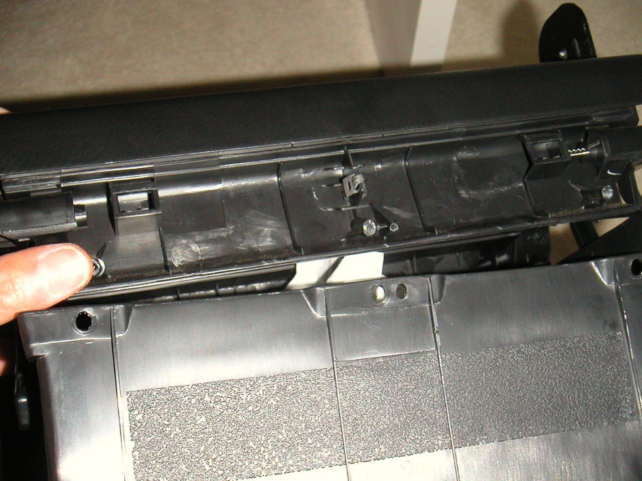

Detail shot of the slots on both side under the screw. (You'll need to remove the panel "Roll bar lower trim" behind the seats. See pic 4 above)
And finally the 2 screws on the bottom (You'll have to pull up the center console-two clips)
