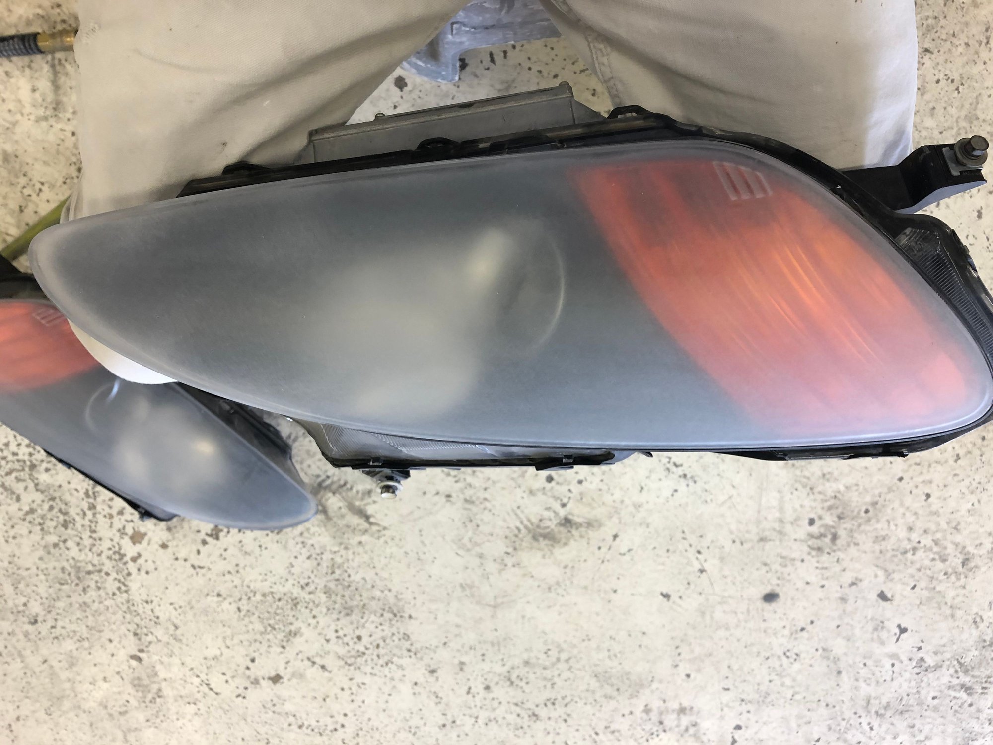

There's only one way to do them correctly. Obviously you're starting with something like this...
The only way to repair that is to remove that top layer of flaking plastic. These have to be sanded down like so...
A good "DA" sander is what you want to use 600 grit, 1000 grit, 3,000 grit if I recall. You then follow it up with buffing, like you're buffing a car. Really, that's exactly what you're doing, wet sanding and buffing. They make a little buffing wheel that attaches to the end of a hand drill, use that with a wool pad. It will look great at this point...but it won't hold up, you have to use another product. There was something mentioned in the post above mine, I don't know anything about it. The best thing you could use is clear coat for painting cars, it has the necessary UV protection and it finishes the lights beautifully. Apply that, 1,500 and 3,000 with your DA, buff again. You should end up with this...

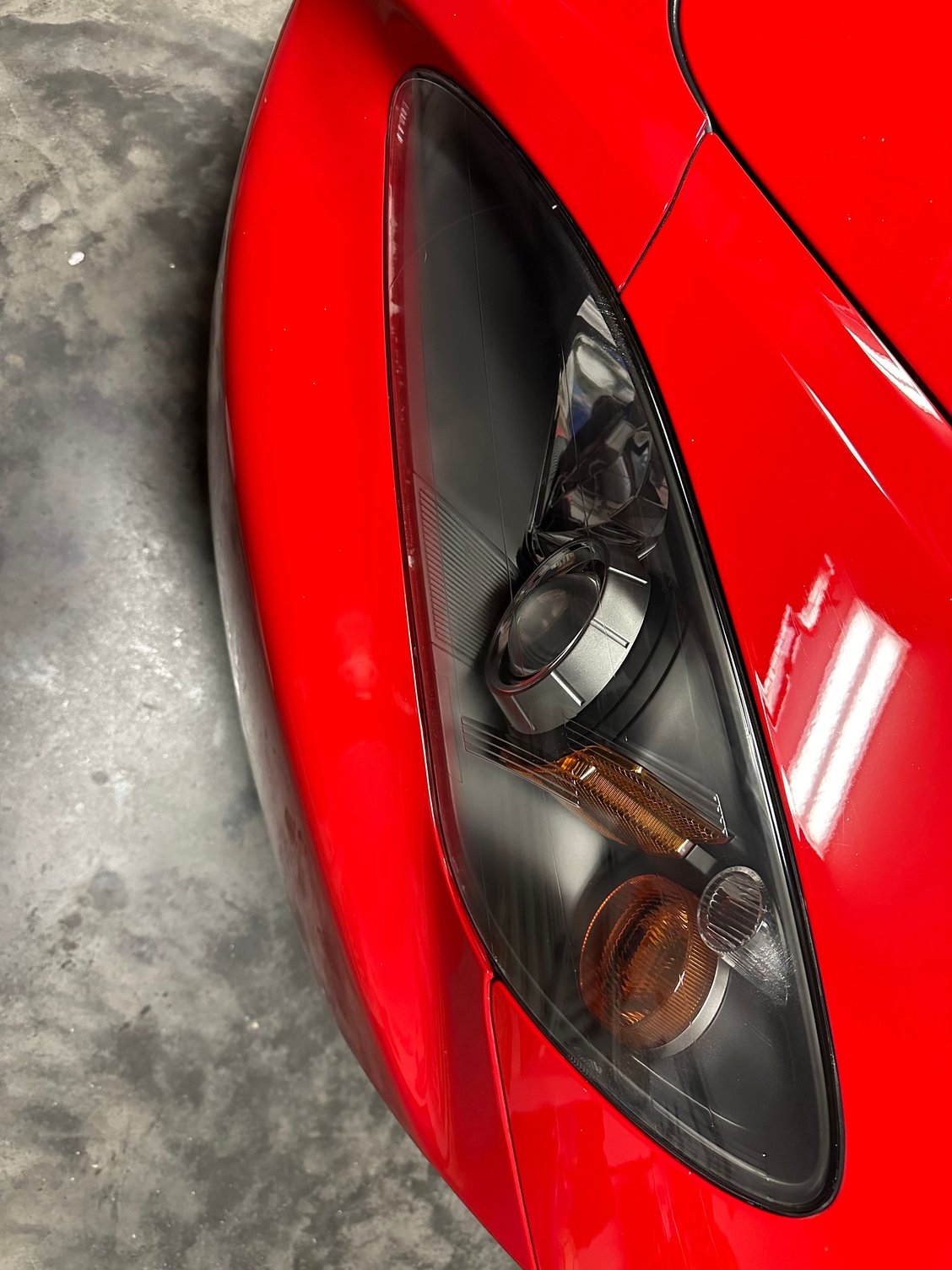

This is not a product endorsement but wanted to share my recent experience using Chemical Guys Headlight Restorer and Collinite No 845.
First off, my headlights were not in terrible shape. They were mostly clear but with some light hazing on bottom half of lenses.
First tried to apply the Headlight Restorer product only with a microfiber towel. Shined the lights up a bit but wouldn’t remove the tougher haze. No sanding done with this approach.
Second try I decided to use my DA polisher and some 2500 grit wet sanding paper. My steps were as follows:
  1. Washed lights
  2. Used clay bar on lights
  3. Wet sanded only the hazy areas of the lights with 2500 grit
  4. With DA polisher applied Chemical Guys product to an orange medium cut pad (two rounds of application on each light hand buffing residue with microfiber towel after each application)
  5. With DA polisher applied Chemical Guys product to a white light cutting pad (applied 2 times on passenger side light and 4 times on driver side light, which was in worse condition; again hand buffed out the product with a microfiber towel after each application)
  6. Used the 1800 rpm setting on DA polisher for all product applications
  7. Hand waxed lenses with Collinite No 845 and hand buffed with microfiber towel
My overall takeaways are:
  1. Chemical Guys Headlight Restorer was a good remedy in my situation. Very pleased with the results.
  2. A DA polisher was required to remove the light haze and multiple applications were required to produce the clearest and smoothest results.
Unfortunately I didn’t take any before pics. The attached after pics tell the story. For the keen eyed members who blow up my pics, you’ll notice some small micro cracks near some of the edges of the lenses (That issue is discussed
elsewhere in an S2Ki forum). Those do not buff out.
