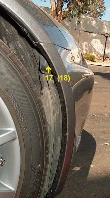

Use the 8mm socket to remove the two screws on the inside of the wheel well. Pic 4 - numbered 17 and 18 (not shown but in same location as 17 on opposite side).

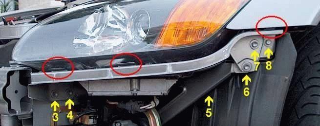

Use the 10mm socket to remove the two bolts holding the headlight assembly to the fender. Pic 5 - numbered 1 and 2.
Detach the "corner upper beam" by removing the four 10mm bolts in Pic 6 - numbered 3, 4, 6, and 7.
Use the 10mm socket to remove the two bolts holding the headlight assembly to the fender. Pic 6 - numbered 5 and 8. The bolt numbered 5 will require an extension on the socket wrench as it is somewhat hidden between the fender wall and the metal brace under the headlight.

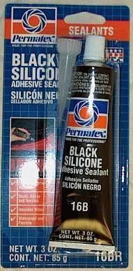

Use some type of adhesive sealant and apply a bead inside the groove of the black piece where the clear piece fits in. (See Pic 8 for the type of sealant I used. I bought this at an auto parts retailer.) Ensure there are no breaks in the bead of sealant and be liberal with it - you want the headlight assembly to be airtight after reassembly. Place both pieces back into the oven to re-soften the old glue. I put them back in at 225F degrees for about 7 minutes. Push the two pieces back together and verify each tab is locked. Mine required another trip to the oven so I could push the two pieces together even more. After the second baking I wrapped the headlights with a towel and wound a strong string around the two pieces so continuous pressure was applied while the sealant cured. (If you do this just make sure the towel is lint-free and the string will not "shed". I had some lint and string-stuff make its way into the headlight assemblies after they were sealed. It was a big pain getting that stuff out.)

Bolt the headlight assembly in and re-attach the "corner upper beam" as shown in Pics 5 and 6. Don't forget the hidden bolt (#5).

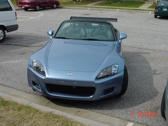

Here is my sample............
