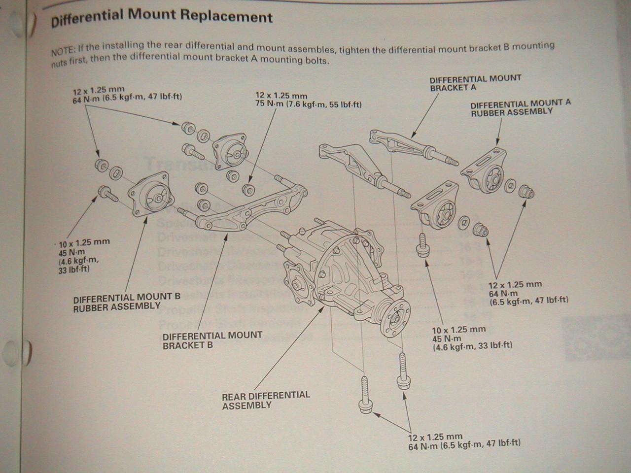

850's Avatar
850
Posts: 777
From: Duluth
This is the Differential, which is connected to the propeller shaft to the transmission!
Here is the exploded view of your drive shaft, which has to CV boots on both sides!
See how the inner shaft joints the differential?
