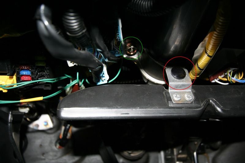

1. Remove the black clip circled in red so you can swing the long black piece out of the way. Then unbolt the 12mm bolt circled in green. There are two of these, one on each side fo the steering rack. (torque to 16lb-ft when reinstalling)

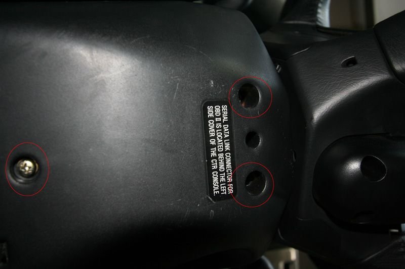

2. Unscrew the 3 screws circled. Then carefully remove the lower half if the shell around the wiper/light controls.

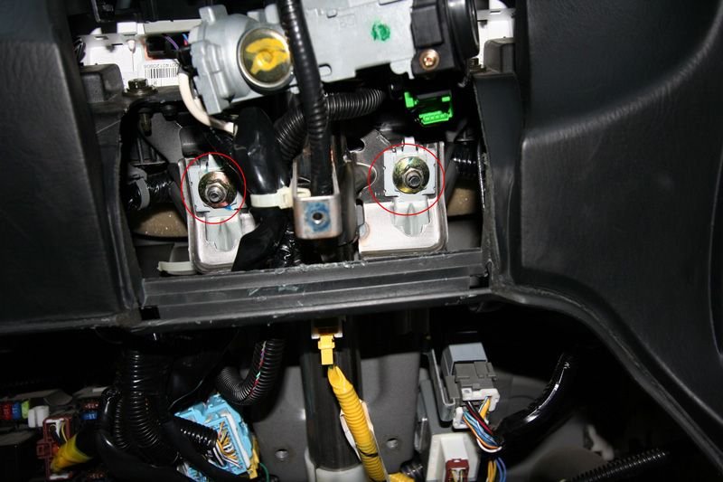

3. Unbolt the 2 circled 12mm nuts. The steering wheel should drop now and clear the dash bezel. (torque to 12 lb-ft when reinstalling)

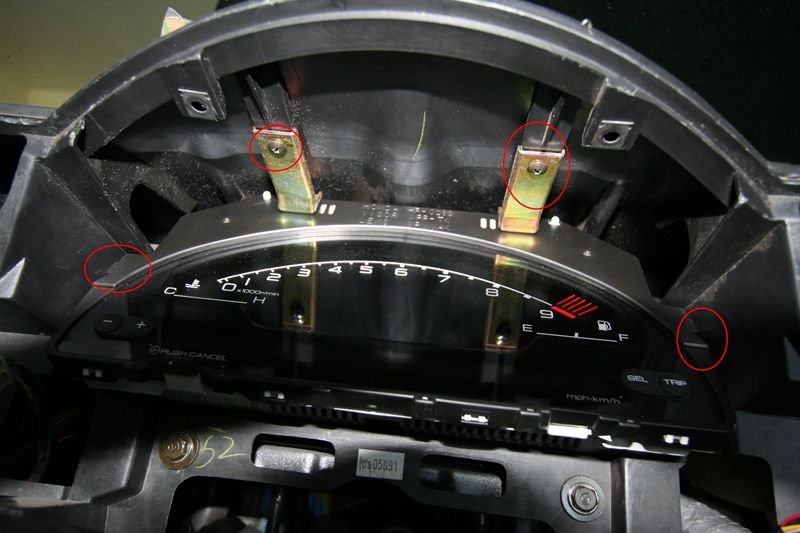

6. Unscrew the 4 circled screws. Carefully tilt the gauge cluster forward and unclip the electrical connections in the rear.

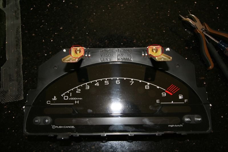

7. Unscrew the 2 circled screws.

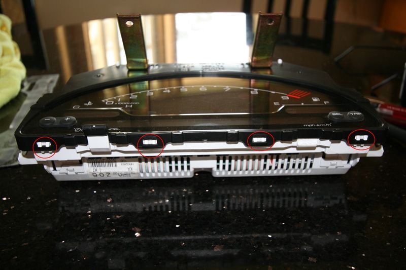

8. Using a mechanics pick or small flat head, unclip these circled clips. There is one on each side.

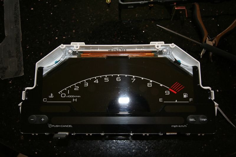

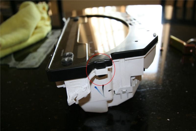

9. Carefully unclip the circled clips with a mechanics pick/flathead(be very careful not to crack these). The black trim should now come straight off.

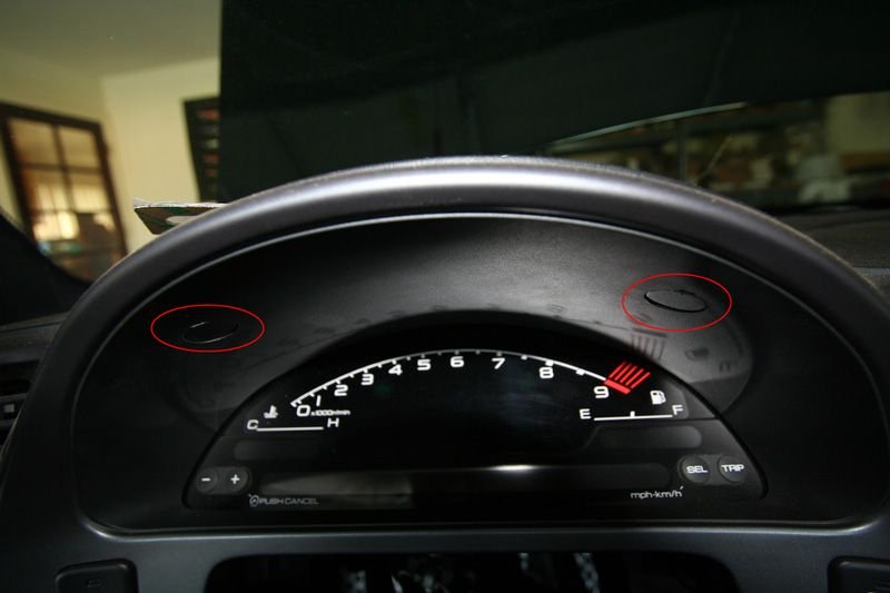

10. This is what it should look like with the black trim off. Make sure the surface of the gauge cluster is free of oil and dust before applying the CF trim.
11. Reinstall in reverse order. End result should look something like this:
