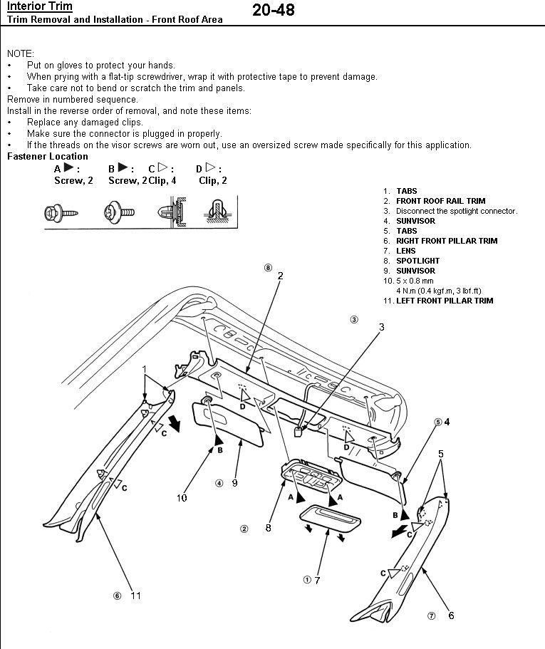

What is the easiest and cleanest way to remove the dome light cover?
Hate to scratch any part of my S.

Using a little flat head screw driver. You need to get to it at the front, meaning the windshield side, see diagram above.
