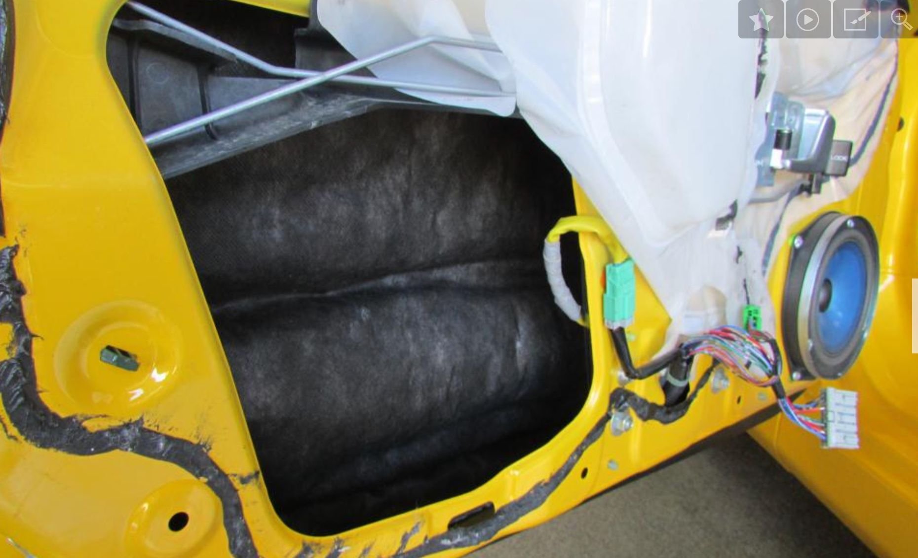

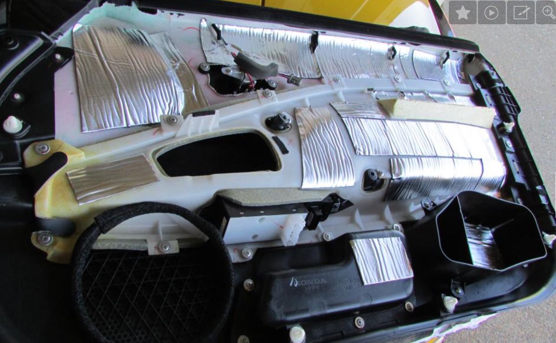

I would put some strips of Dynamate or some suitable NVH (Noise, vibration, harshness) on the inside skin and perhaps even add some other material. It will greatly improve the sound of the speakers and also deaden the road noise. You will have a nice "thunk" when the door closes.

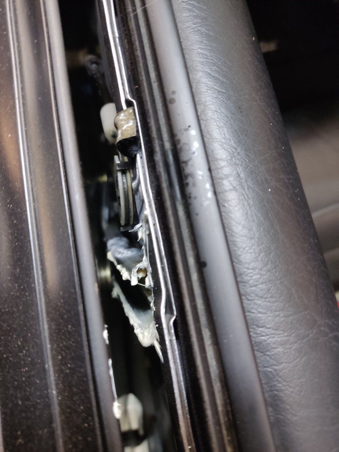

Done. I removed the door liner. You could see the channnel wich guides the window, one pulley and the uper part of the cable wich moves the window from above.
The grease was in real good conditon after all these years. Still soft. It was white and the feeling between my fingers made me choose Liqui Moly Marine Grease from my stash. It also white, sticky, Waterproff, Plastic friendly.
I simply put the grase into the channel from above, worked it down the channel with a long screwdriver. After this, i moved the window up and down a few times while spraying Teflon / PTFE spray on the cable and pulley.
Done. Reasmble the door liner and clean the window from grease and spray residues. it took me 15 Minutes for one door.
The success was not so great as with my del Sol back then, but still, the window moves a litte bit smoother and the sound of the motor is a little bit reduced.
So, it´s up to everybody do decide if it´s neccesarry. But feel free to take care for your baby on a lazy, rainy sunday.
