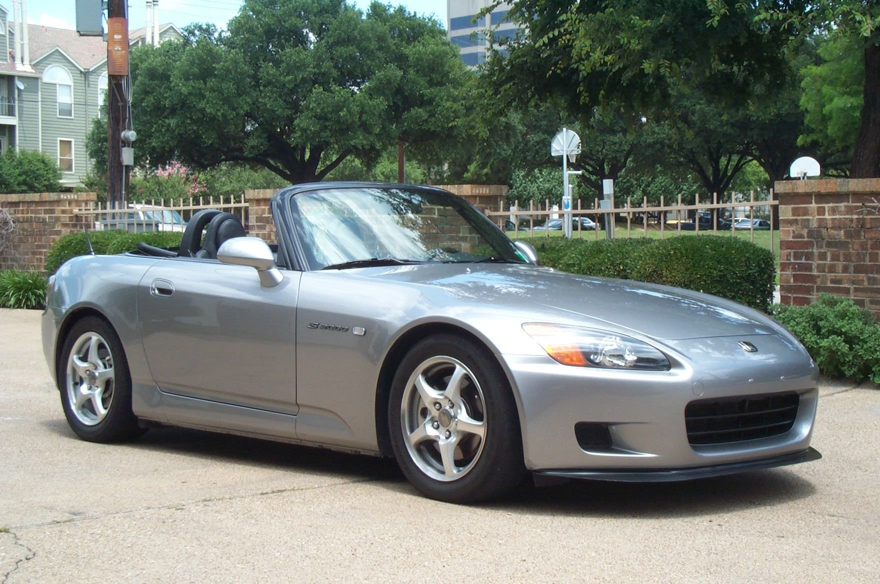

I was looking for some aero aids but with my car lowered an inch and my driving on the older broken streets of Dallas, most front splitters would not last. I wanted to try an RM and my brother predicted it would last an hour on my car. So I thought a Coastal Metals unit would at least be harder to tear up.
With a good stroke of luck I asked xviper about pics of his silver car with the unit and he not only sent them but made a generous gesture offering me the splitter since he no longer used it. Once I got it and put it on my car I saw why.. mounted it is actually at an angle that looks a little odd (at least on my car) so I did not see the performance or appearance advantage I was seeking. But not one to give up on the unbreakable splitter idea I asked my brother (a unix admin that is really better at aircraft repair) to modify it for me.
We cut a couple of channels in it so that we could bend the curved metal down and used a metal brake to put a 25 degree downward angle on it. It's not perfect, and I had to paint it because the power coat got a little damaged. I also removed the edging although that does show some minor imperfections in the edge. It was mounted on the car and I used body tape to close the gap between it and the bumper. Looks like this:
The end result is pretty amazing. As soon as I got the car to about 70 mph I could tell there is some affect, with the front feeling better planted. Over 100 mph it is a different car, with more precise steering and solid tracking. It really works!
I left it on and have completed a full track event where I think it was helpful and had no negative affect. I plan on a rear wing soon, now convinced aero aids make a much bigger difference than I thought. And to top it off I have scraped it numerous times driving these crappy streets with no damage.
My thanks to xviper.. this post is at his suggestion.

Looks good. Sounds like a lot of work. Glad it seems worth it.

That looks far better than stock. Perhaps you could show CM your mods and they could incorporate it into their design.
I don't like it stock, but that looks terrific - and it's indistructable!
