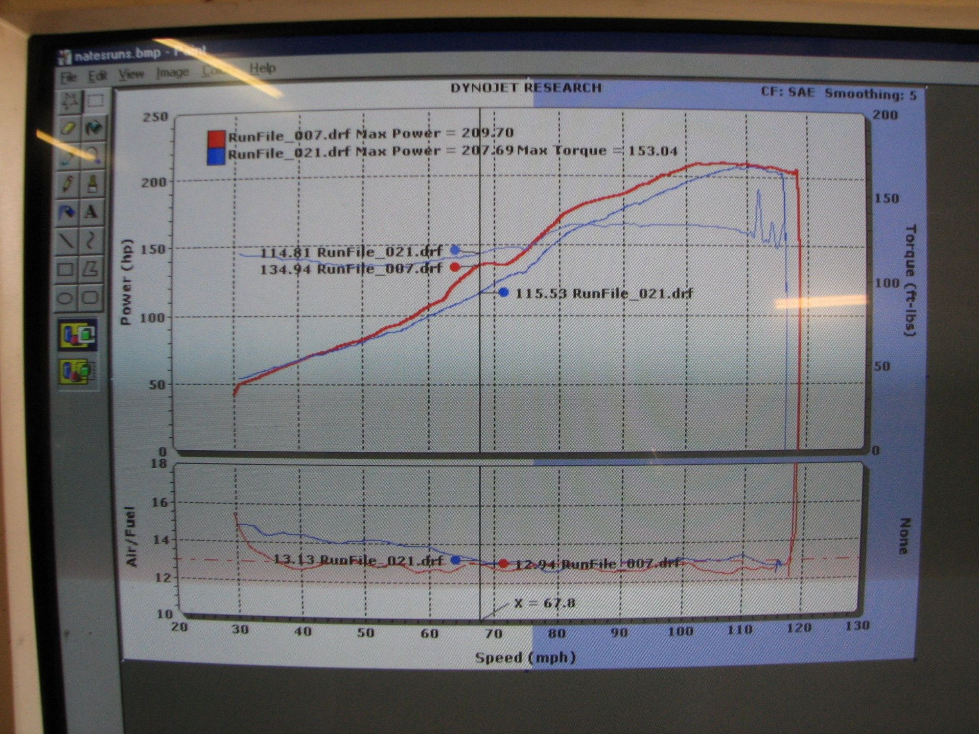

You will need an AEM EMS or equivalent standalone to run ITB's. In order to run right, you'll need the wideband O2 model (1052U), and at least 440cc/min injectors. I baselined stock, with AEM EMS, and then finally AEM EMS + ITB's. My EMS run on a stock engine put the stock 320cc/min injectors at 64% duty cycle at 100% engine load at 9000 rpm. My ITB setup uses SVT 440cc/min injectors, and they peak at 66% at 100% load @ 9000 rpm. My timing map and fuel map look very, very different from the stock maps. The ITB setup may fire with the stock computer, but it will run like crap and probably run very, very lean, since the stock ecu looks for the narrowband O2 sensor, among many other things, and you'll need to spend a great deal of time dialing in each pill on the fuel and timing maps to get it to run smooth...but once you do....oh boy
Here are my dyno's:
Baseline 186rwhp 122 ft/lbs
AEM EMS and AEM EMS + ITB comparison...the blue line is my car with JUST the AEM EMS, the redline is with ITB's and AEM EMS.
This is my latest tune:
My final delta (plotted in excel from dyno graphs)
Hope that helps. There's a great thread on ITB's in the JDM tuning section. You'll find alot of very useful information in there, plus you can ask me just about anything ITB...I've been fine tuning mine for almost a year now
