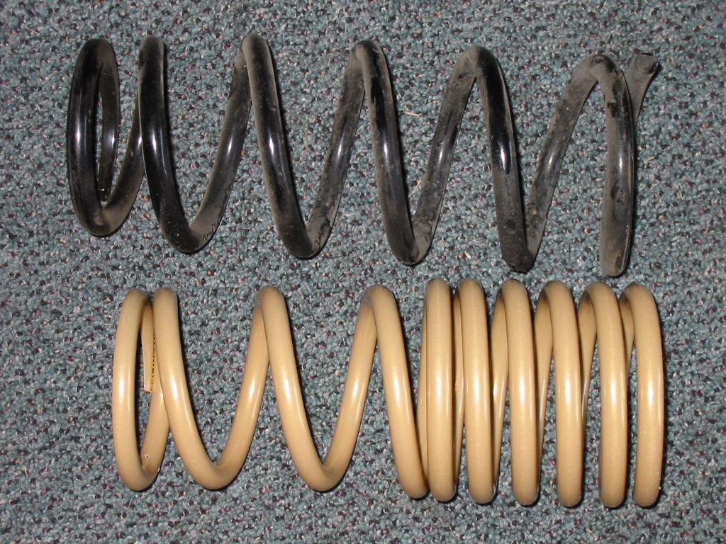

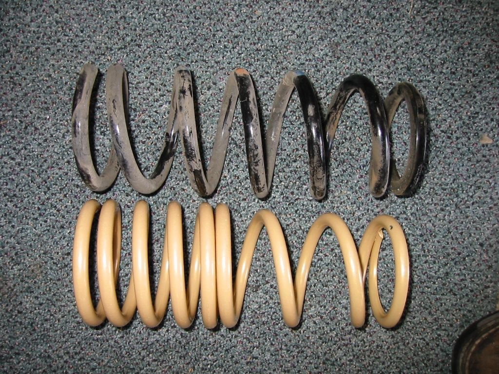

Some visual aid.
Front.
Rear.

damn it... i wonder if they will reinstall it w/out charging me. its definitely higher in the front. thanks for the pics. ill look at the spring before they / i out them on again. i might just have to do it myself. if you want something done right, you gotta do it yourself.
