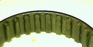

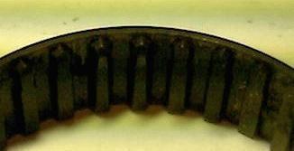

again, please excuse my camera, I really need to get a better one. I cant even get the whole frame evenly focused
Here is the second gear syncro sleeve, you can see what I call the tooth ramp second gear side is facing up, there are only two teeth with ramps in this photo.
And this is the reverse syncro sleeve, notice how these angles are not very steep:
This one is after grinding reverse, you can see the points rounded off:
You might be able to see the ramps better on the reverse syncro sleeve:
