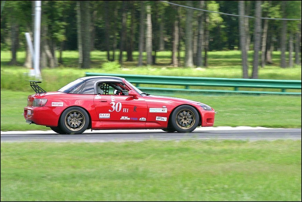

Here.....my car weighs 2400lbs with hardtop and rollcage but with no fuel...
It is not street legal...
to save even more weight
- make the rollcage just a rollbar
- cut out the door bars out of the sidedoors
- Lightweight battery (I have stock battery)
- Remove the air pump (mine is still in)
- Get rid of the extra wiring (to the power windows, locks, etc...)
- Lexan window for hardtop
- remove bumper beams...(just don't get hit by anyone)
All of that would be nearly free stuff and

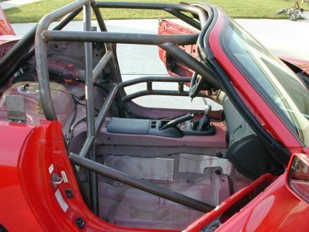

my car is a race car...weighing just under 2400 pounds....in order for me to compete in NASA's 25 hours of thunderhill with my cage size I need to get the car right at 2200 pounds...the cage is built with C-M at a 0.095 wall thickness, but they seem to put C-M in the same class as mild steel down there in NASA. My cage was built under Canadian rules. So I do have a PROBLEM.
