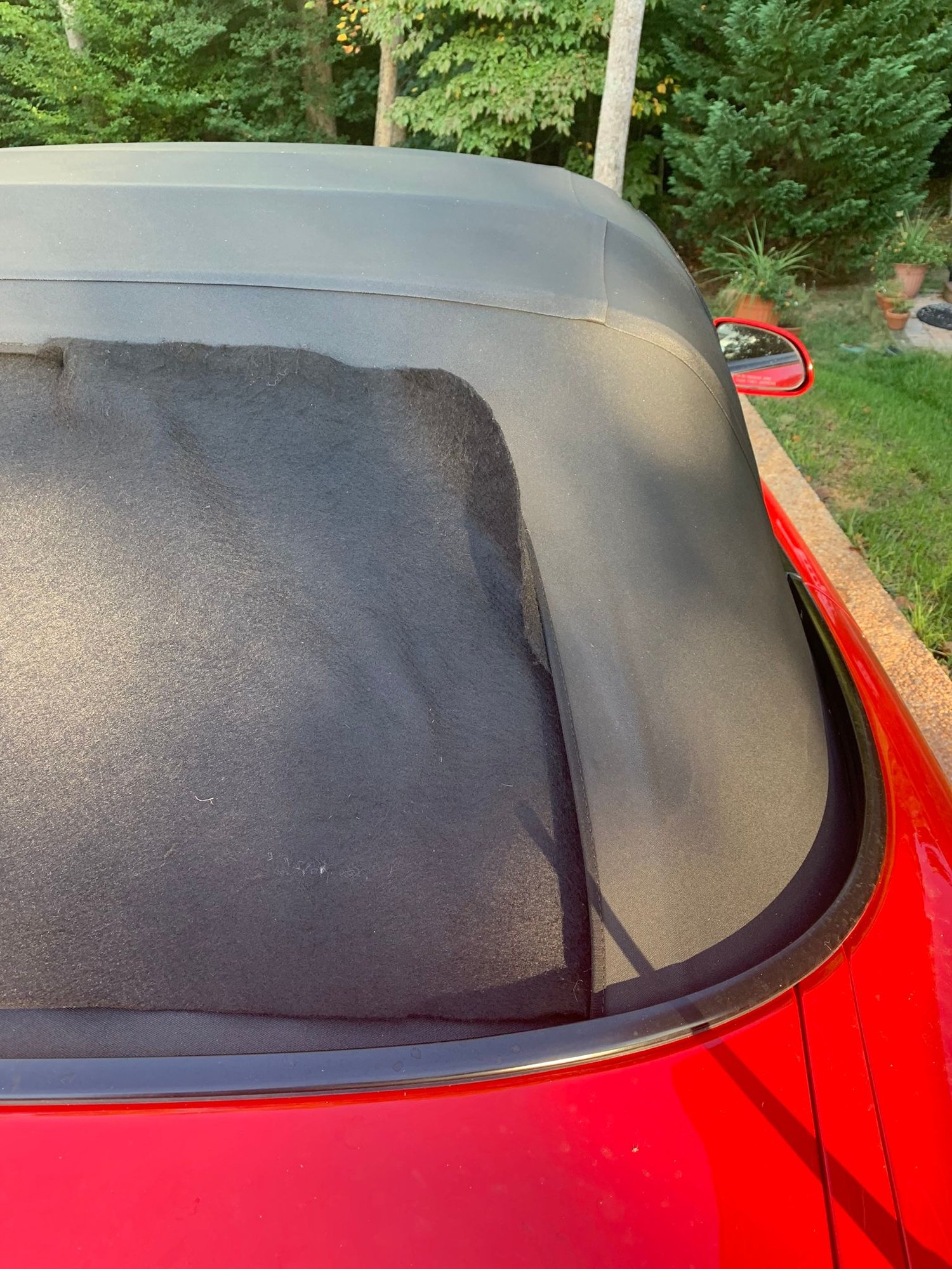

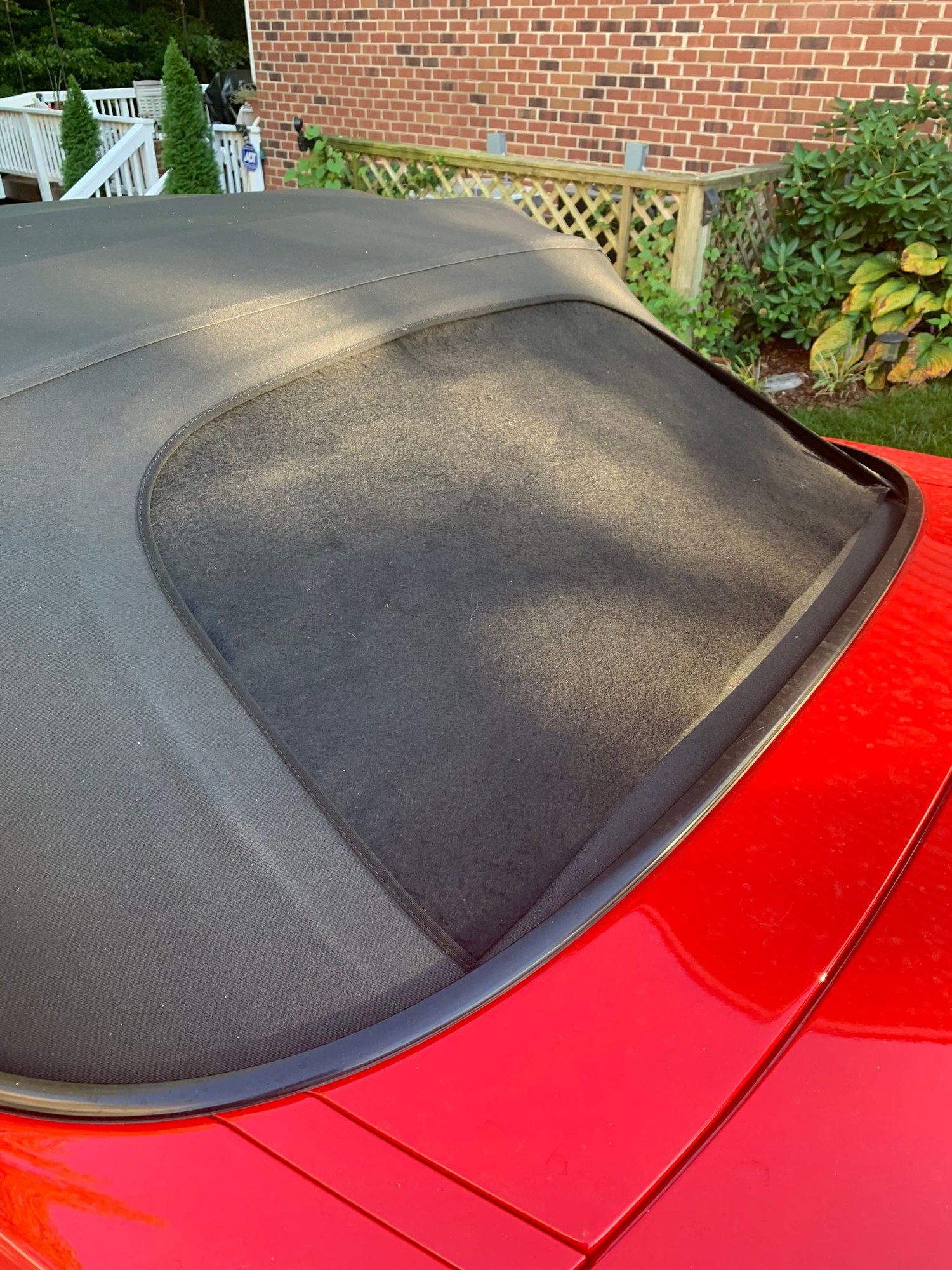

I have a vinyl window in my ‘01 and when I replaced my top I cut some black felt and fit it in the back tray where the window rests when down. I then cut another piece to fit the outside of the window. This keeps it from rubbing against itself while driving.

Yes Birdybog, that is a good idea. There are basically three things you can do (and I am stealing the words from another forum member below):
1) The rolls (pool noodles) you can buy are to prevent creases from forming in the plastic and to keep the plastic from rubbing itself when lowered.
2) The mats you can buy are to prevent scratching of the plastic from inside the car after the top is lower into the storage area.
3) The elastic straps with velcro ends that Greg sells are designed to stretch the plastic to make it taunt when it's up and in some case assist in aligning the plastic as it's folding when being lowered.
I'm interested in the third option as I have already taken care of the first two.
