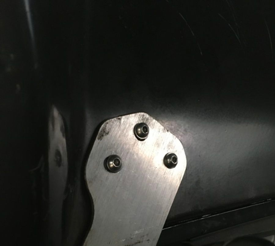

From some google searches and watching some hardtop install youtube videos I can see there are several different bracket styles.
From memory, the ones on the car look something like this:
In watching some videos It looked like the bracket with the hardtop mount point might replace a bracket that sits where the lower bolts go. Is that true? Nothing I saw showed the lower mount points very clearly.
I'm wondering if something down there might make the soft top not operate if I remove the hardtop bracket. Could some critical bracket be missing (replaced by the hardtop bracket)?

These are some of the cheaper style rear hardtop mounts; looks like you should be using larger washers; so these kind of suck as you either need to take off all 3 bolts as there are 2 under body panels that you don't have pictured.
As far if they are good; they are the cheapest one you can get; I personally like OEM style; I have a OEM race style that is 2 piece; it's really you get what you pay for.
As far as something missing you are fine if you are using the OEM latches at front one thing to check with; make sure the softtop latches are there and it wasn't reused on the hardtop
This is VERY VERY COMMON! I had to buy another set of soft top latches one for my hardtop and one for my soft-top. I guess you could swap them in and out but it's such a pain in the butt
