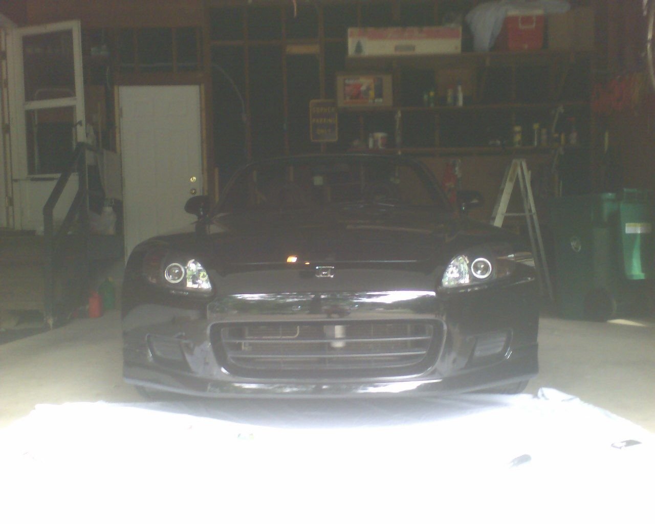

I've had my s2k a few weeks. I've noticed when you look at a stock s2k, and even modified ones, you see an orange reflector lense inside the corners of the front headlights. My s2k does not have this...it is just clear as if both sides are missing the orange reflector that sits inside the plastic headlight assembly. You can see my bulb as well.
Are these some sort of projector headlight or something installed by a previous owner...or, were the orange parts just taken out? I think it looks better this way, but was wondering because I haven't seen any projector headlights for this car available.

you can crack the lenses open and remove the orange diffuser.. can be replaced with smoked or clear. Not a good idea to remove it completely with out replacement. So, do you have a clear diffuser, or none at all?

most likely the previous owner took out the orange deflectors.....i took mine out and left it clear as well...looks sharp
I do not believe I have a diffuser because I can see straight down to the light bulb. No clear lense has been installed. Just a yellow lit light bulb.
