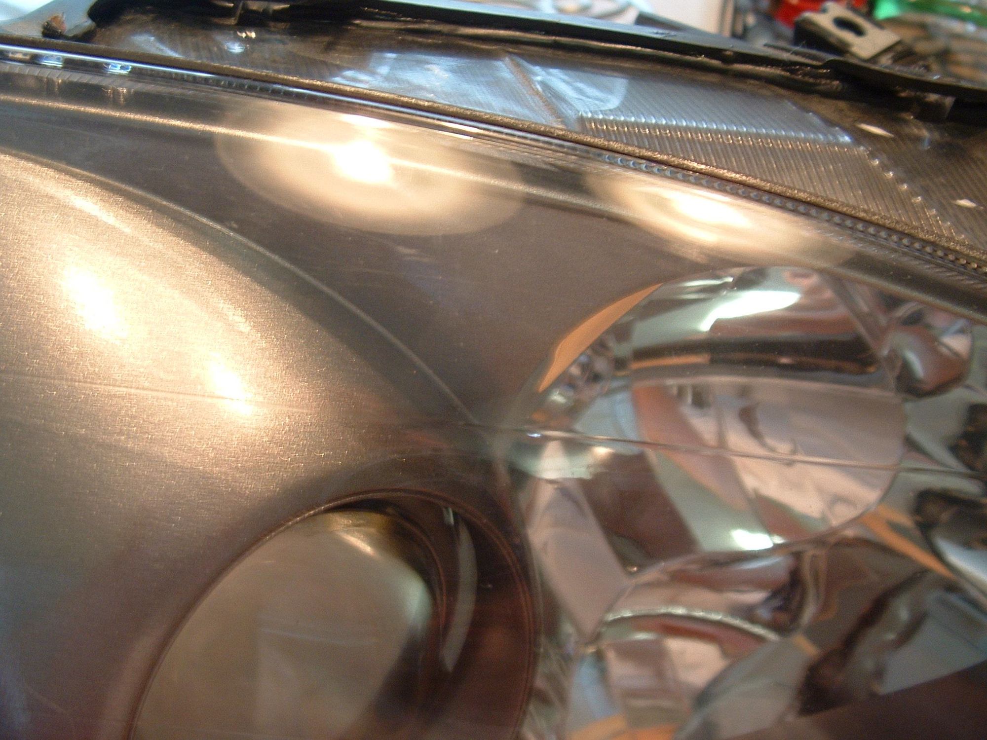

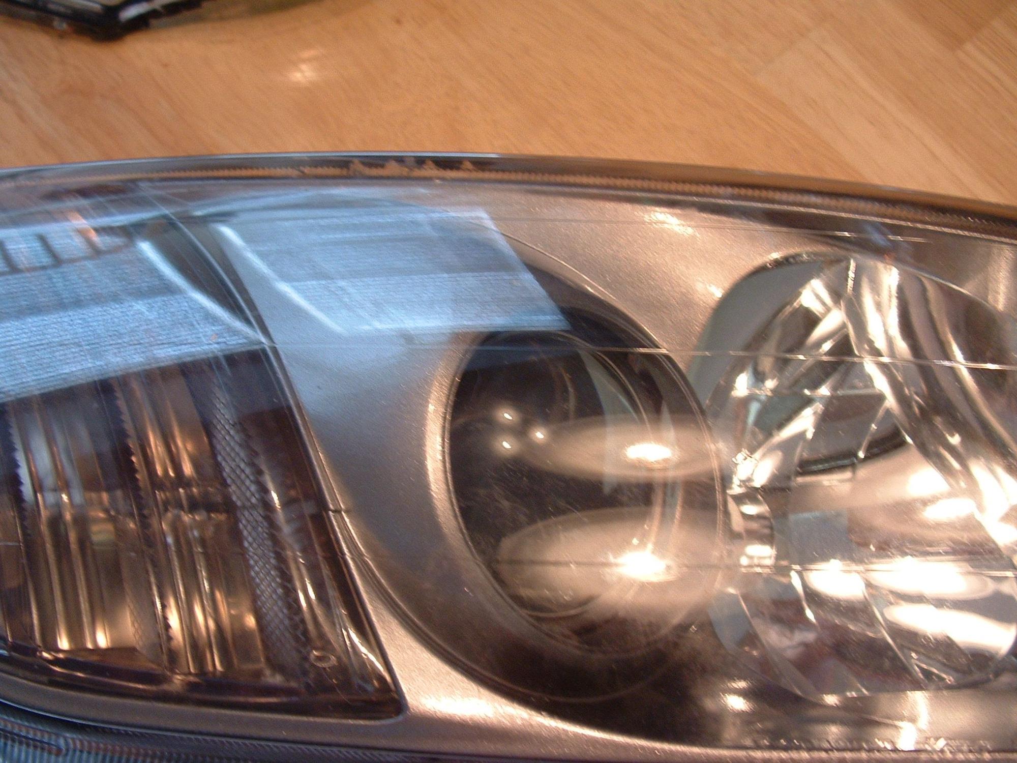

Ok, the unbaked headlight is on top, the baked one is on the bottom.

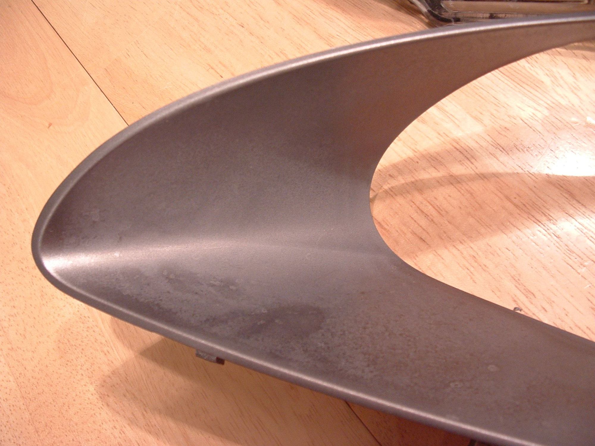

Here's a closeup of the baked headlight insert.

Brainstorming here, I think I'll try to bake the gooed one using paper to sit it on, paper shouldn't burn until 350-400deg F, so 225deg should be safe, especially for only the 15 minutes or so I still have to bake. That should make it a dry bake and I'll see what happens.

Success, the dry heat worked better than with the damp cloth.
Brown paper bags, a-la old style grocery bags worked great to insulate the headlight assembly from the metal rack.
Here's the oven:
Here's the completed headlight: I appologise for the blurryness of some of the pics. Bad camera, no doughnut.
