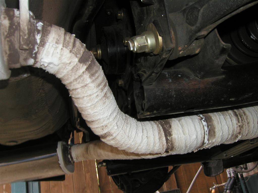

So I'm following up on my progress on drone/heat suppression on the exhaust pipe itself under the cabin.
Here is a great comparison thread on Sound dampening compounds.
http://www.sounddeadenershowdown.com/
From this comparison, I found a High Heat resistant liquid dampener called SecondSkinAudio Spectrum Firewall
http://www.secondskinaudio.com/cgi-b....cgi?pg=2&p=ps

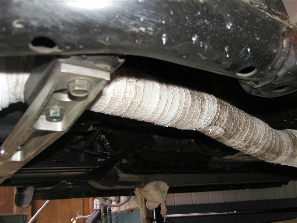

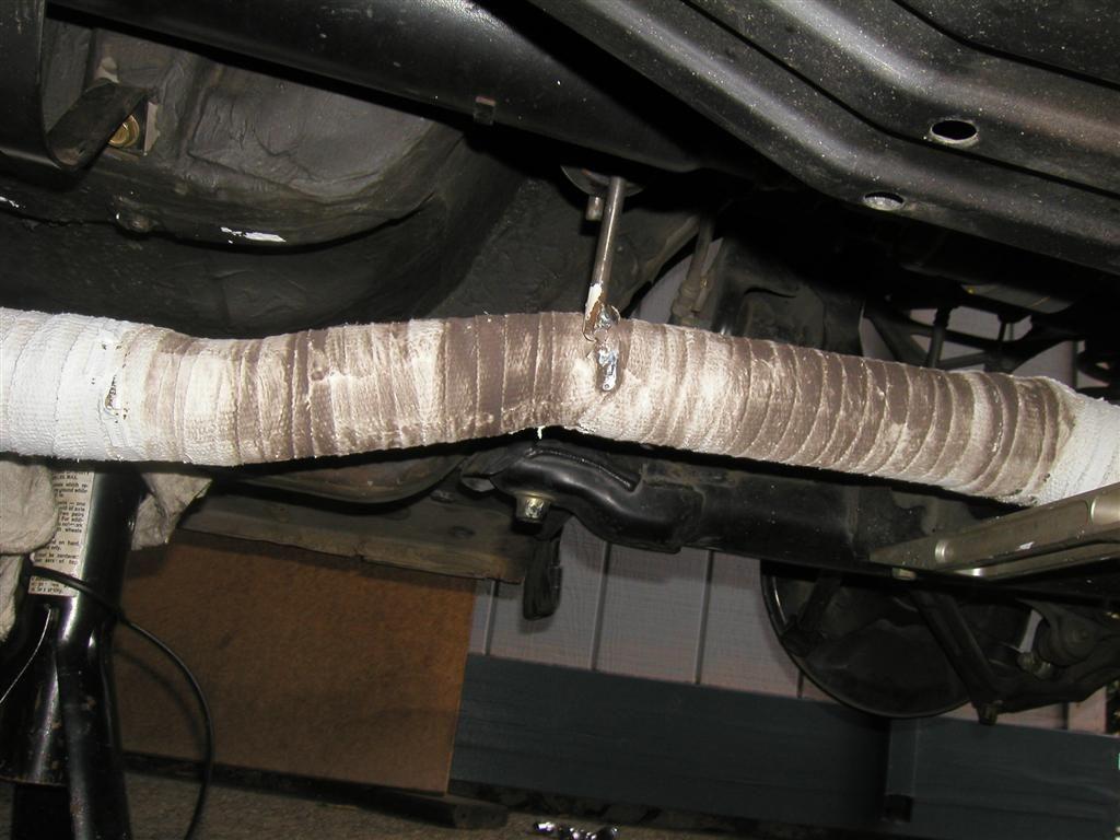

I coated the heatwrap to waterseal and add to heat/drone suppression on the pipe. I then TESTED to see how well it would hold up at the TRACK
After 150 TRACK miles (5 thirty min sessions) this is what it looked like
You can see the hottest portion of the pipe is where the resonator use to be
Looks like it held up very well so I will give it another coat and continue my experiments

Ever since I put the testpipe in, the db level at WOT increased at least 50%. The 3k-4k drone in the cabin went up about 25%.
After doing the heatwrap, my drone is back to a livable level but by no means are we even close to a stock db level in terms of drone or WOT.
I noticed that covering the "Y" portion of the pipe really attacked the drone frequency so I am still concentrating there. I LOVE the BEAST level these magnaflows tune to so I am hesitant in start partially covering the cans themselves. At some point I will probably coat the top of the cans and I will post up then.
