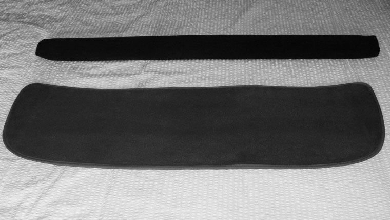

Here's a thread on a DIY mat. I made one myself out of a black bathroom rug, the kind with a rubberized underside. Just get one big enough that you can cut it to fit the tray that the top sits in.
https://www.s2ki.com/forums/s2000-ta...rry-muz-91349/
The pool noodle is inserted into where the window folds, you have to do it on the outside of the car, maybe pause the retraction at the halfway point, insert noodle, then retract the rest of the way.
And here's a pic of an original Muz Mat.

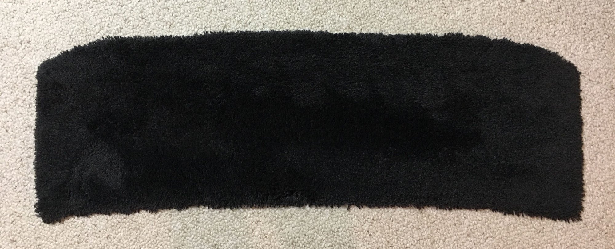

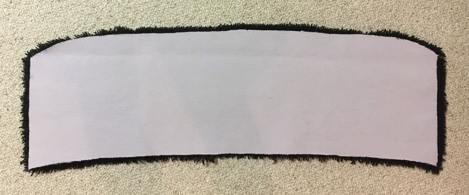

Figured I'd update this for anyone doing this in the future. Made a template out of newspaper, transferred it to cardboard for a better model, and then traced the cardboard and cut out of carpet. Honestly, it was a lot of work to get a shape I was happy with but I have no regrets. For anyone who may do this, only go as wide as the ridges in the rear "tray" where the top folds into. I used a $24.99 black rug from Kohls. Got a coupon from someone and it came to like $17-18. I was worried the carpet fibers would fall out when I cut out the shape. The ones on the edge of the cut do but there are more than enough to fill their place that are 100% solid. The end result isn't noticeable in the back and I like the longer fiber carpet to collect debris like s2ka said. Really happy with the end result. Thanks for the help all
