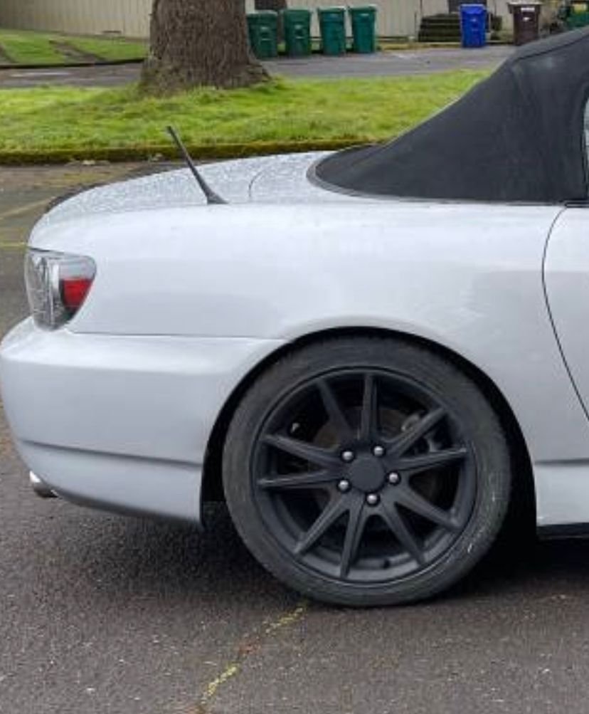

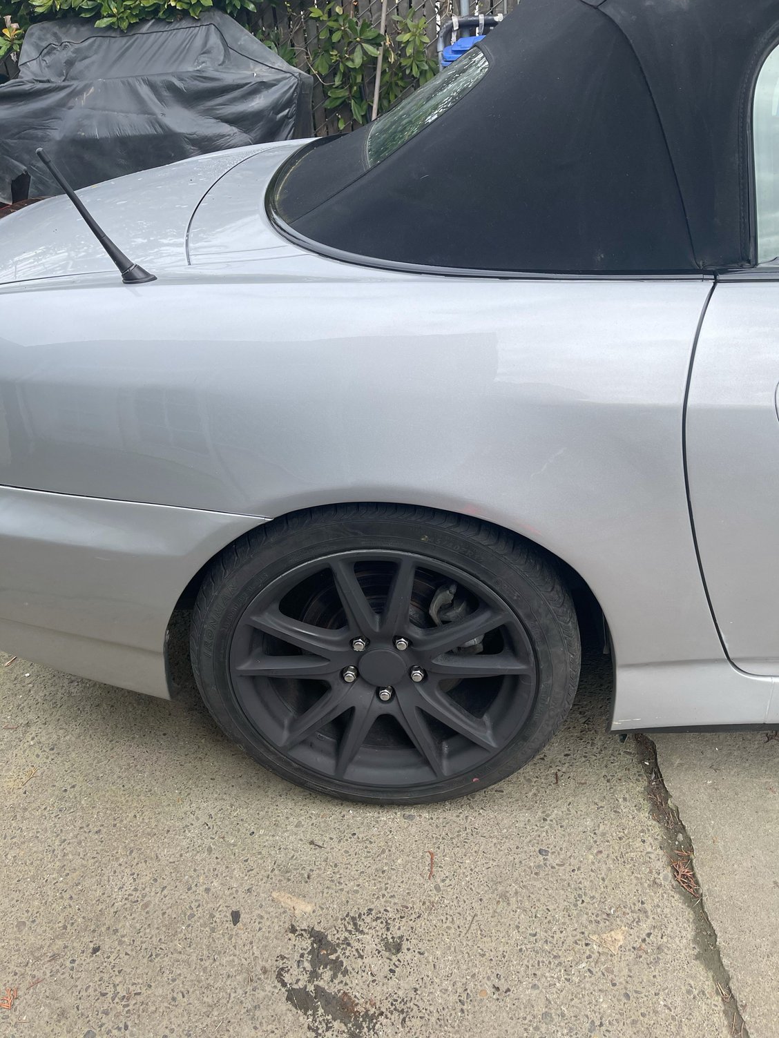

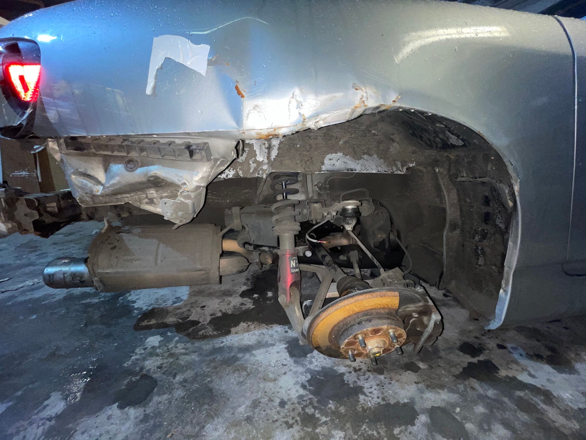

Hello all,
I am thinking about buying a car that's been repaired.
Rear quarter panel and drive shaft damage.
I am attaching a photo and wanted to get your guys opinion on the damage and things to check when going to look at the car.
All constructive comments (emphasis on the constructive) are appreciated haha

Did you take the picture of the repair or did they send you that? Because it looks odd. The seam in the quarter does not line up at the fender lip. And it is blurry in that area and looks like it was photoshopped. Maybe it is just the pixelization that is causing that but it looks odd to me.
In terms of the damage, it is hard to say. A lot could have been damaged looking at that first photo. The OEM quarters are prone to rust even in original form, so would want to know they properly repaired and added any corrosion protection in between the skins of that panel for sure. And would be good to see a report from the alignment shop to at least know they were able to properly align it afterwards. The hard part is if they repaired it themselves, they most likely did not get it to a bodyshop that could measure how far out the frame/subframe was. Also, if that impact damaged the axle/driveshaft then I also would worry about the control arms, subframe and even the hub.
The issue for me is that if they did the repair themselves, there is simply no way to know how far they looked for other damage, if the repair was done properly, etc.
That's an old photo the owner sent me.
What do you mean by this? Could you just elaborate a little.
They replaced the entire hub ect

My concern was just that the damage likely affected those components. If they replaced the entire hub, I assume they likely did the knuckle. Main thing is that you know the car can be properly aligned at least. That will not tell you 100% if it is perfect, but at least able to be aligned into factory specs. Having the alignment checked would tell you that much. Again, it may be maxed out to get it just into spec (so, for example you may be at the edge of the adjustment range) but if you just want something to daily drive a bit and the price is right, just knowing the alignment can be properly set is good.
