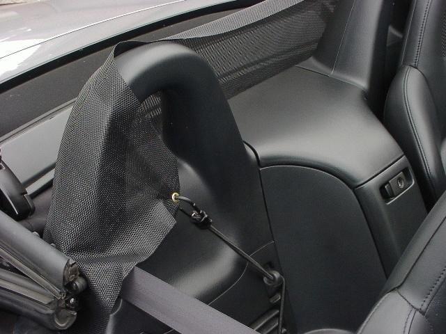

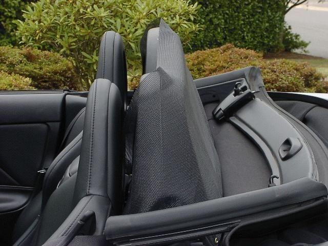

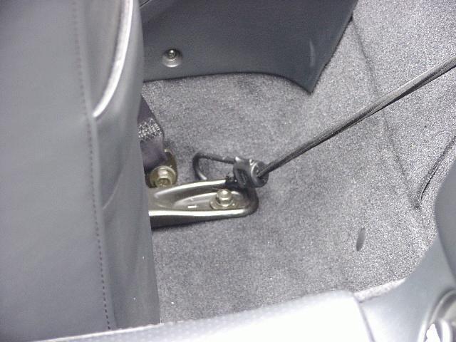

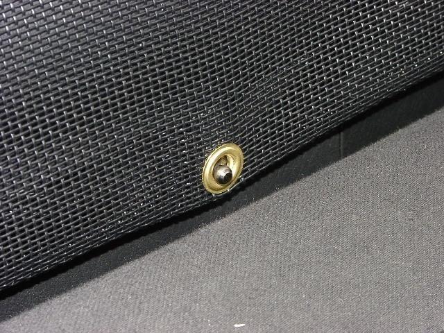

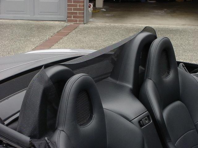

I've always thought the mesh wind deflector like the Z3 was a good idea so I hacked one up. I used pet screen from Lowe's and 6 grommets and 2 bungie cords. It took all of 15 minutes to make and it works great and looks ok from a distance. I simply cut the mesh 14" wide by 54" long. Folded over the mesh 3/4" on the bottom and put grommets in to line up with the four top cover snaps behind the head rests. I then put grommets in the two upper corners and bungied them to the seat rails via the cargo hooks behind the seats. I'm pleased how it works and it doesn't make oscillation noise like the extended plexi types. Also visibility out is fine. Oh and the top easily goes up and down with it installed and you can still open the secret compartment. The thing can be put on or off in less than a minute. (The mesh actually looks better than the pictures show. I think the mesh messes up the digital picture.)

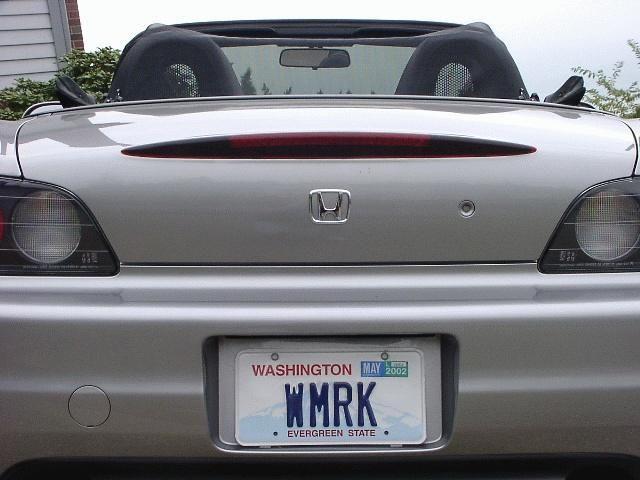

Originally posted by socal28
Can you see out the rear through that?
Yeah. The pictures make it look a lot denser than it is. No problem at all seeing through it.
