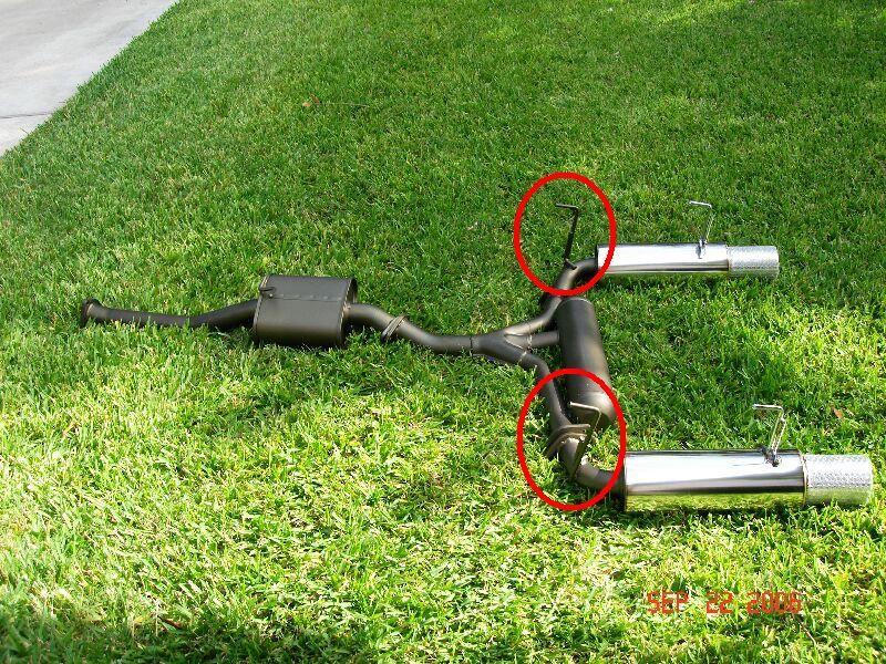

If the rubber hangers are like the ones I used for my Invidia, they are a triangle with two different length sides... using the long side, my Invidia looked like that. Also not sure of the construction of the HKS, but there might be a way to adjust the pipes themselves? That's going to scrape... bad.

If you used all the hangers, just put a hose clamp around the two closest to the bumper. Then you can adjust how high or low you want each muffler to go. I also put a zip-tie around them to make sure they don't pop off.

thats not normal.

Just a wild guess but, could you have used the hangers in the wrong places?

Originally Posted by revhi,May 24 2007, 08:25 PM
Oh, you didnt send me this pic. Your rear hangers are to short. It should be longer so if forces the tip angling up and clears your axles.
Like this:
Hey, this pic looks familiar.
Oh, wait.. that's my car!!
I could go right outside and measure that for you.
But could you clarify what hanger you're talking about?
By metal hanger, do you mean the metal hanger from the canister?
or the rubber hanger for the rear?
Dan

you need to unbolt the pipe that connects the two mufflers (unbolt it from the single pipe behind it that goes in to the cat), position it so it's higher, then bolt it back in when it's in the position you want it. it worked for me.

These hanger brackets.
