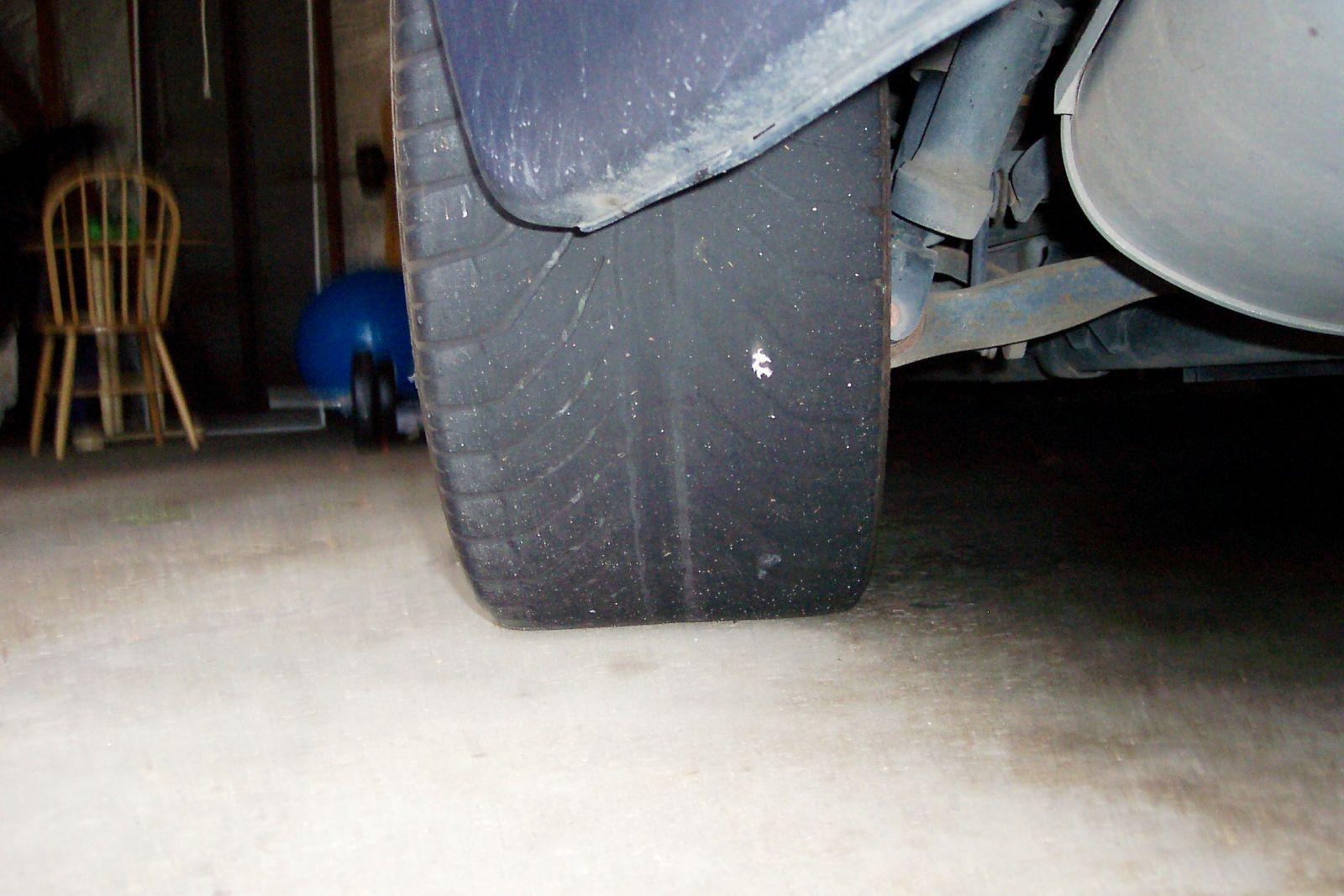

I took my car to honda before the FreshWater tour to have my rear wheels re-aligned... I was on my second set, and these... like the first... were wearing heavily just on the inside tread.
So they spend about 5 hours re-aligning my car that day.
but...

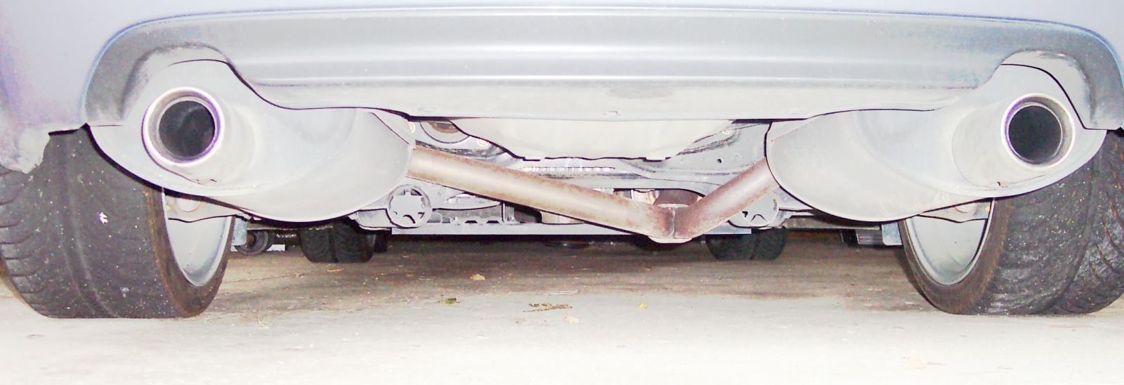

3000 miles later, my tires now look like this!
My right tire still shows decent tread and maybe has about another 5k on them (which should hold me for another month to month and a half...)
The left rear, however... is completely ing bald on the inside, and almost to the outer edge!!
What did they do to my car!? The tire's should look like the same... and now the left doesn't look like it could last another week! I had to drive in the rain yesterday and was forced to turn on the hazards and drive on the side of the highway at 35mph! and even then... the car felt as if it was going to spin!
Can I pin this against them to get them to replace the tire? or am I stuck getting screwed?

Looks like a combination of too much rear toe out and negative camber. I had a similar problem and my front tyres got shagged within 2000km! The alignment shop gave me back my money and helped subsidise the cost of new tyres, then I took the car to a Honda shop to have it aligned properly.
Hopefully they won't stick you with the bill since it has been 3000 miles already. Next time monitor your tyre wear carefully every tankful after an alignment or other change and have it checked out before the tread is totally gone.
Apparently some machines or technicians aren't skilled in the double wishbone suspension the car uses.

I would be very curious to know what specs you were aligned to- I agree with the other responders who think 5 hours for alignment is crazy. How many miles were on the tires prior to the alignment? Are they stock wheels?
I recently had my care re-aligned at 11,000 miles (after first set of rears) and initially it felt off- but it turned out it was a tire pressure issue. As soon as I got the pressures up to spec the thing was great.
If you search, you'll find many people have had the alignment off from the factory. Keep in mind, however, with the amount of rear camber our cars run, you will always wear the inside edges down first. I suspect the toe was not right on your rears, which can give the rapid tire wear and feathering pattern you see.
Good luck- looks like your in for some new tires. I had the same issues in the rain- literally could not go over 40 mph on the highway without the rear end fishtailing on me. Pretty sad to see a brand new, high performance car running 40 on the highway with the 4-ways on!

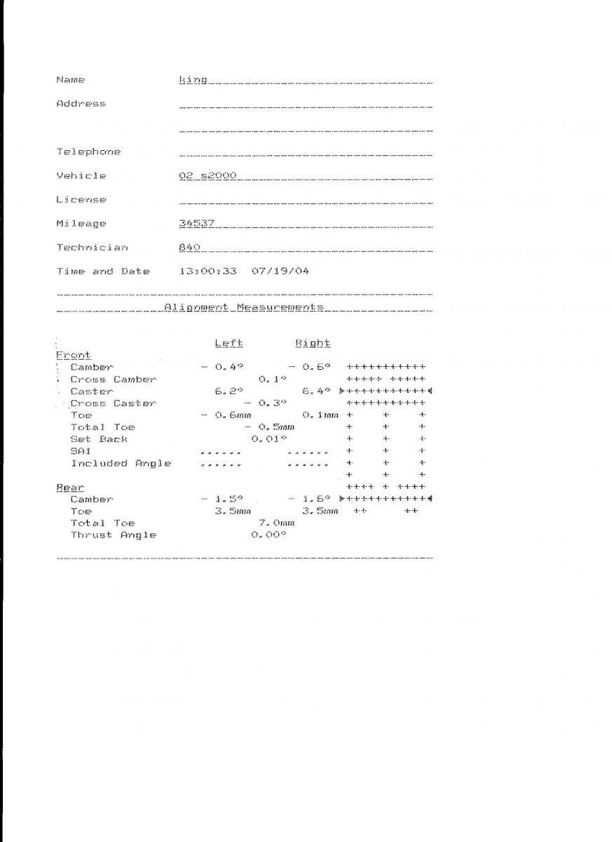

alright... here are the findings...
remember... I have 18" SSR GT1's, with Kumho's... So someone please give me insight on whether the numbers look accurate!
Honda was all ready to replace the tires for me... but then called me back to the shop to show that the numbers were actually just fine... and that there was nothing wrong with the alignment job that they did last time...
if this is true... how in the hell did the left tire wear so unevenly!!??
Originally... how bad it was off
What they corrected it to...
What they found today...
also... what they found today...
