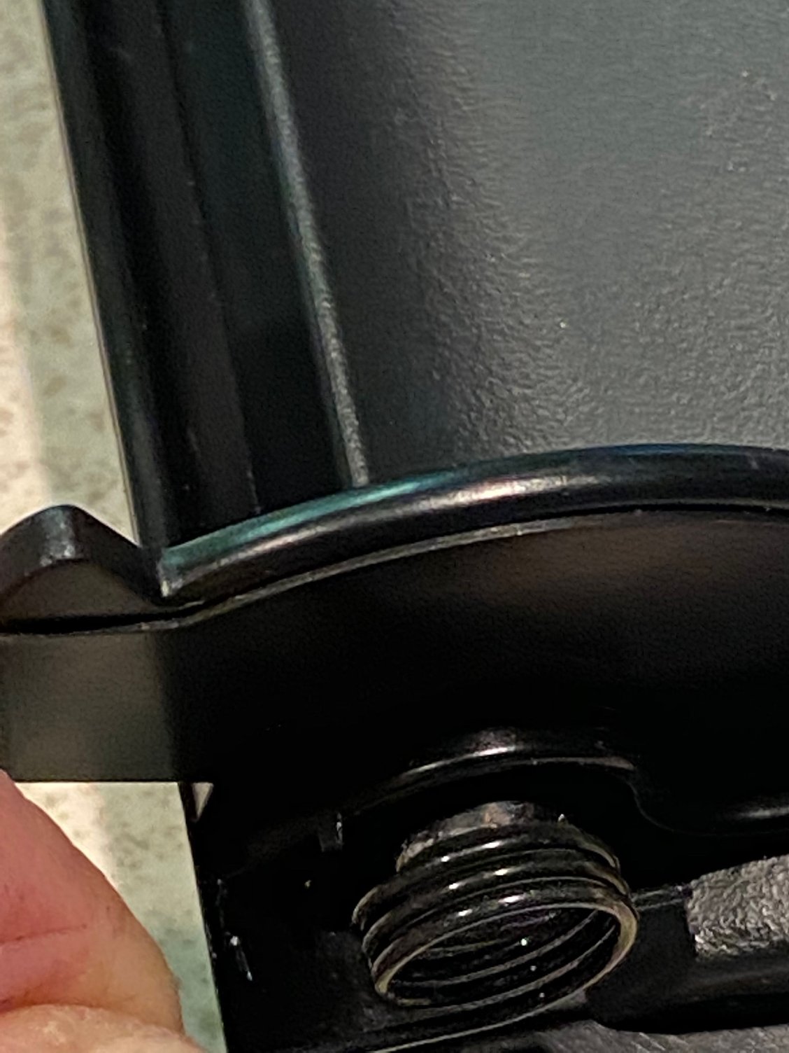

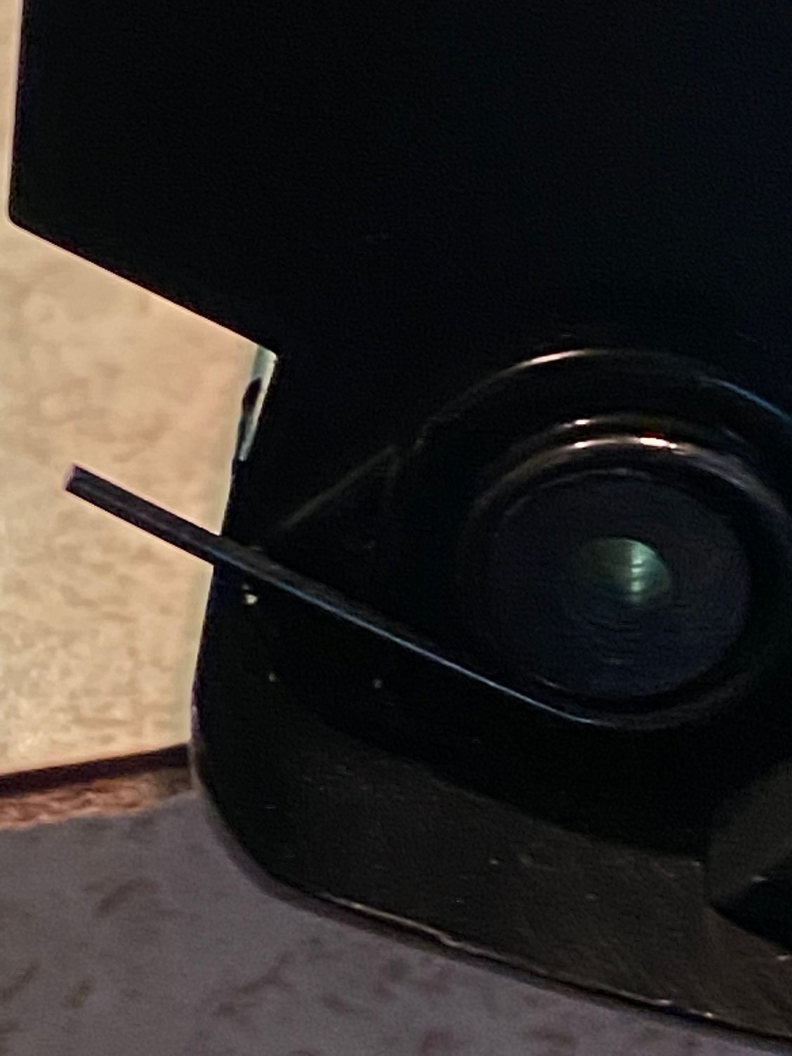

I managed to install the spring and the door in about 10 minutes once I figured out how the spring works. First thing to do is install the right hand door hinge pin.
At this point the door is still movable. Now take the spring and install it on the door first with the short end of the spring down and forward. The next step is to hold the spring in place with your finger and start moving it in place with the longer end of the spring just resting on the inside bottom of the door. Now start moving it in place by continuing to hold the spring with your finger make sure the door is still a not lined up so that you can take a small flat screwdriver and push up on the longer end of the spring so that it slides into the slot on the door frame. At this stage all that is needed is to slide the door pin in place. continue to hold the spring with your finger until you have the hinge pin completely inserted.
