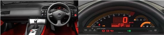

Default Japanese 04 Redline at 9K
I was wondering if anyone else noticed the 9K redline in the 04 Japanese model.

what the...

Japanese model kept original 2.0 engine. No change in RPMs.
04 NA model got lengthened stroke, so Honda lowered redline for the same piston speed as the 00-03 models.

Regardless of rpm, MY00~03 gauge still looks better though. I really don't like the new dash design. The added clock is the only nice feature though.

i agree. it gets annoying to open the radio door just to see what time it is.
