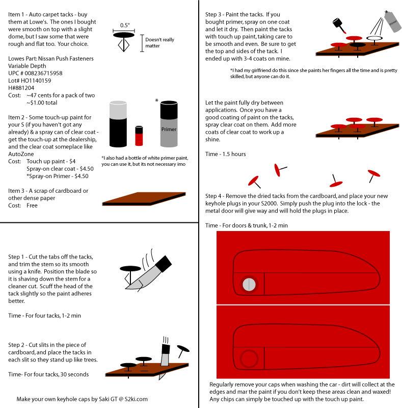

Okay, I've gotten several PMs asking me about making keyhole plugs and how I made mine, so I promised I'd post directions on how I did it. One of our fellow members, billman250, makes fine plugs the he sells for $30 and that look very good, but for some enterprising folks, its more fun to make them yourselves. It cost me about $10 and two hours of my life to make these, so it should cost you the same. Of course, you can always PM billman250 too.
Here is how I did it, in one easy pic. Note that I had little direction to go on, so if anyone has any suggestions they'd like to make, I'm open to adding them to this diagram. Note the primer I had was plastic primer.
NOTE: The more you sand and polish between coats, and the more coats you add, the smoother and "glassier" the caps will be.

Originally Posted by SilverKnight,Sep 3 2005, 02:39 AM
cool man
touch up paint? don't most of our touch ups paints match kind of bad?
My factory GPW touch up paint matched perfectly, and I imagine all touch up paint matches well, since its OEM.
I don't have the time to make these right now. Maybe I'll make some more GPW since I have the materials already, but if you just want to buy them, PM billman250 - his plugs look great.
