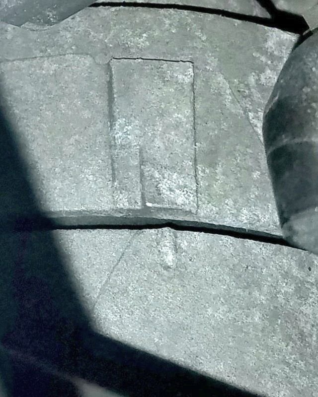

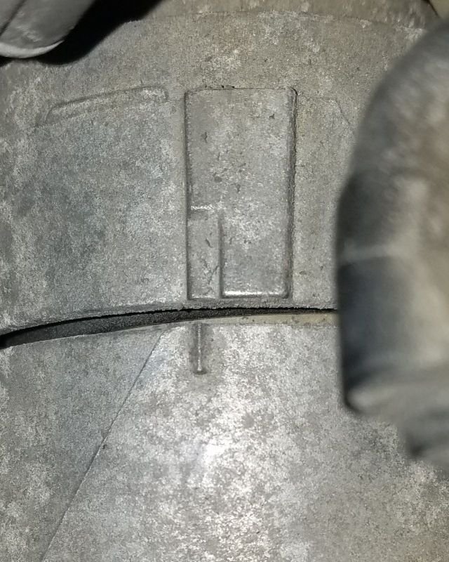

FWIW, here's the difference when I replaced the 19-year old (!) belt on my '00.
Before: indicator well past spec (lower indicator far to the right of the normal-wear region)
Old belt wear indicator
After: Pretty close to the max-tension point (lower indicator nearly at the far left of the normal-wear region)
But yeah, there was no noticeable difference in how the engine runs.
Thanks for the time too show

Same tensioner in both pics?
Old Mar 19, 2025 | 05:14 AM
twohoos's Avatar
Joined: Feb 2001
Posts: 4,063
Likes: 364
From: Redondo Beach
^Yeah, just different lighting and angle.
