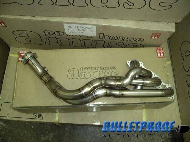

Upon doing further research, it appears that Rick's is not a copy of the Mugen design. I'm sure it's still a very good header, especially for the price but it looks nothing like the Mugen when you put them side by side.
Actually, the Amuse is a carbon copy of the Mugen Design minus the heatsheild mounting points. It is possible that the Amuse uses different diameters but the actual design is the same.
To Illustrate my point:
Mugen
Amuse
Rick's
