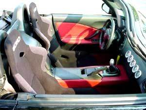

I borrowed this picture from Sienceofspeed.com Hope he doesn't mind...
This is Recaro SPG. Chris also stated that Sparco Rev would fit also. Most other seats are too wide.
