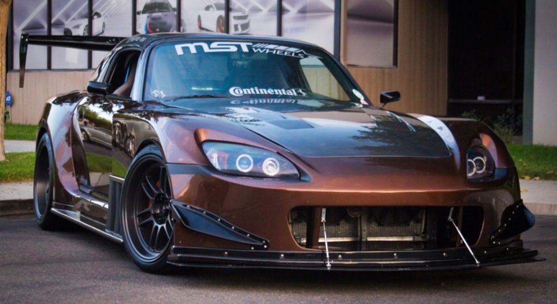

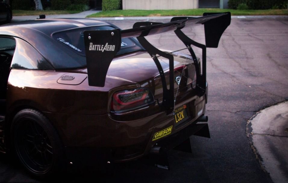

I was bored sitting in a parking lot when I started looking up LS swapped S’s. (Say that 3 times fast). Depending on how much it would cost to rebuild the F if I ever blow it, I might consider LS power.
Love to see some cf covers with HONDA vtec on them.
One mean body kit

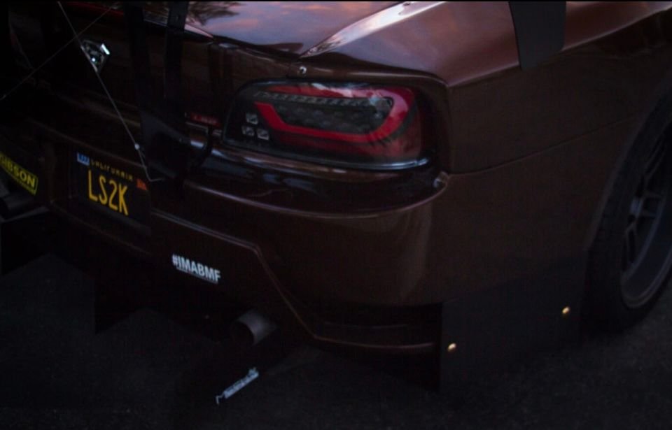

I like the way the body wraps around the taillights.
The Superman S is a solid touch

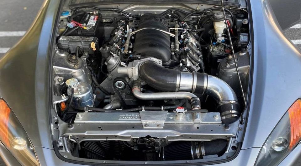

Originally Posted by engifineer
While the LS is a pretty light engine, I do not believe you will get it sitting behind the front axle line like the F series, which means it moves the weight distribution further forward. I have never seen one corner balanced or weighed to see how much, but that affects the balance and handling of the car which is a hard no for me. I guess if someone were drag racing only or just doing it for a street car but this in one application I would not jump to an LS swap for personally. Our car is a front mid engine layout (engine is fully between the axles/behind the front axle line) and that is what keeps it as balanced as it is
this is an LS3 and it sits behind the towers. I’d like to see the scales too.

Still a good chunk of that LS3 in front of the towers. Hard to say how it aligns with the axle line too from that angle. But I cannot see an LS3 not adding to the front weigh bias a good amount.
An LS1 is a good 9 inches longer than an F20C I believe. So at minimum going to shift some weight that much further forward. And accessory placement and size could add to that as well. The LS1 is also about 4 inches taller, placing weight a tad higher unless you can get it lower in the frame somehow and given the oil capacity that may be tough.
Interesting comparison for sure but I bet some others can provide detail on how they did it and the outcome.
