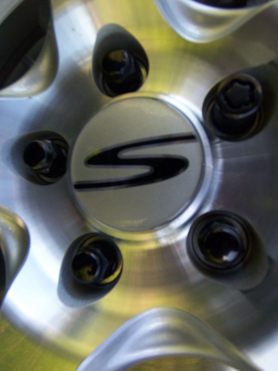

heres a pic with black lugnuts on stock wheels. I bought a set of black locking lugs too, perfect match. i also have a set of the same center caps but with a red S if you are interested. PM Me.

^^^ WRONG SEAT TYPE, don't post if you don't know. This is how misinformation spreads.

You need to make sure you are using ball seat lug nuts (round instead of conical) for stock Honda/Acura wheels. Conical lug lugs won't fit right on stock wheels and can come loose.
With that said, you can go with the stock CR or NSX lug nuts. Spoon also makes ball seat lug nuts (I think I saw on A&J Racing).
