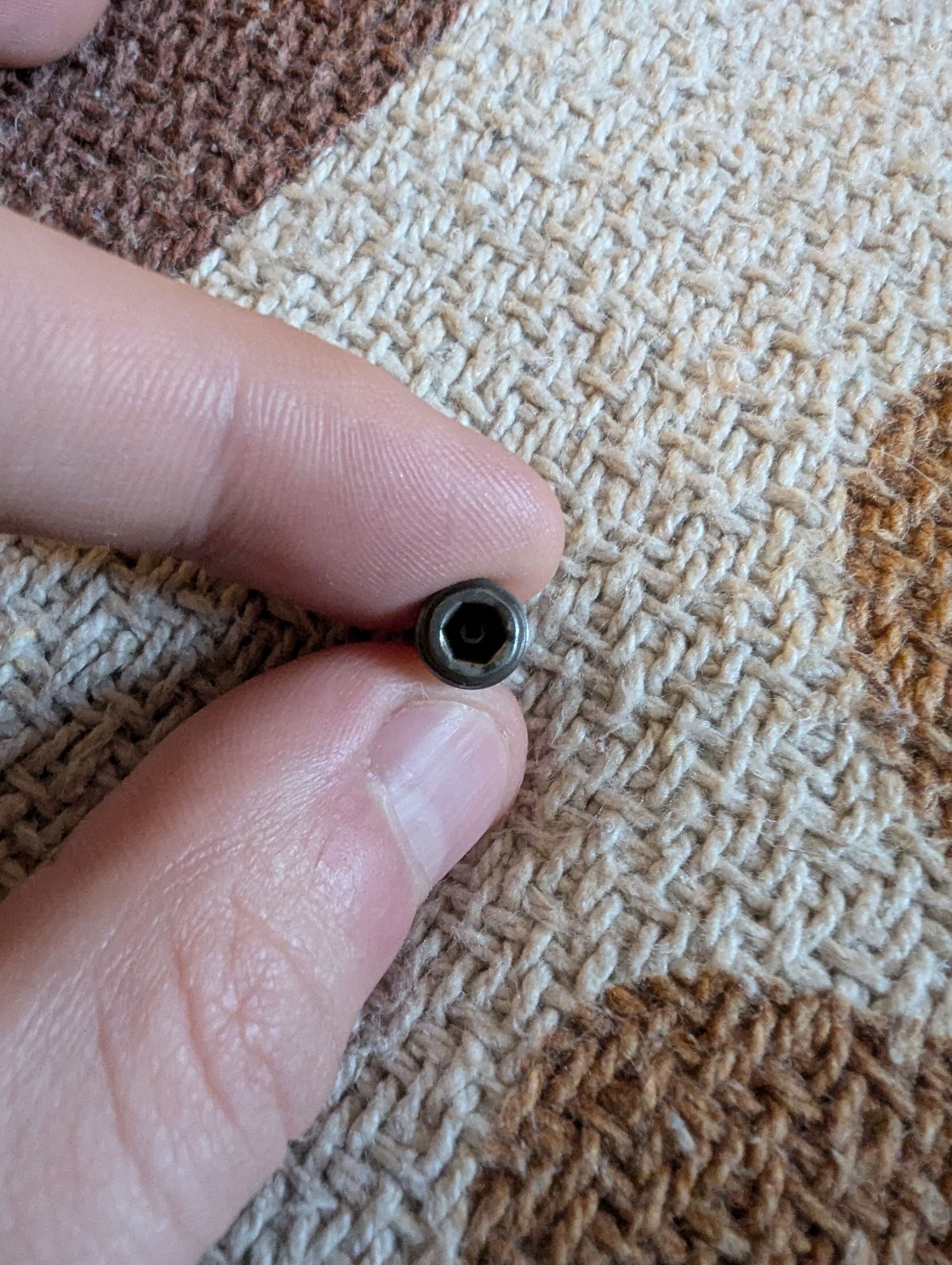

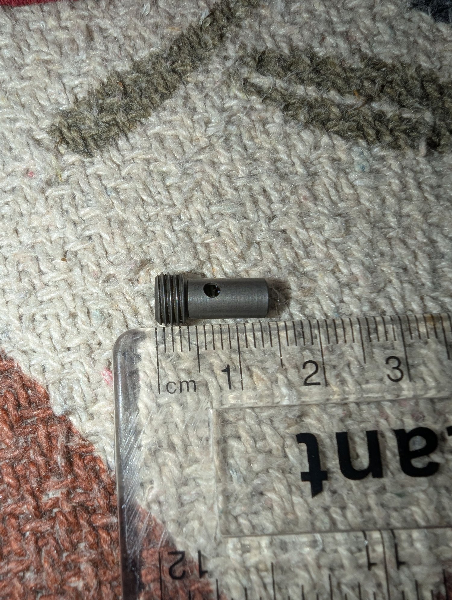

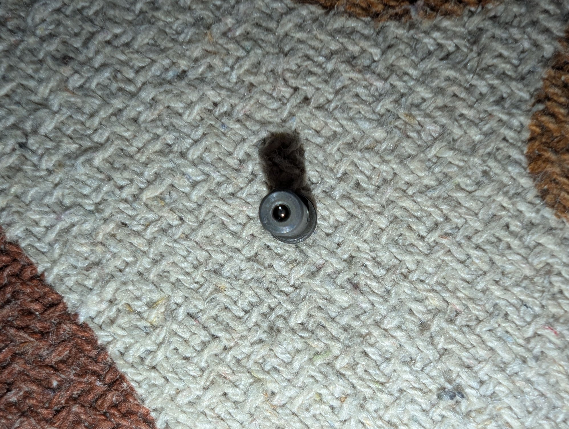

Hello all,
I was doing an oil change when I noticed this valve/bolt in the sump plug exit. I have no idea where this could have come from. I'll attach some images bellow:
It's got a Hex end. Inside is a spring with a ball on the end. I can push the ball in easily with a small screwdriver. It's only about 15mm long.
It looks like it could be a pressure relief valve, but I have no clue where it's from and how it ended up in the sump.
I also noticed a whining noise coming from the engine just before doing the oil change. I'm not sure if the two are linked.
Any help would be hugely appreciated.
Thanks

That is 100% the oil pressure regulator valve of the TCT. It is screwed in the TCT by the factory, then secured in place with some punches ("to caulk"?) in the aluminium body of the TCT.
If this fails for whatever reason, it maybe simply could spin loose.

Check the original TCT and see if the relief valve is missing.
Chain and guides is a major job, and not necessary at this point.
Luckily it didn’t get caught up in the chain, but that missing valve equals a big internal oil pressure leak.
You also need to be aware of any whining noise, which usually signals excessive chain tension.
