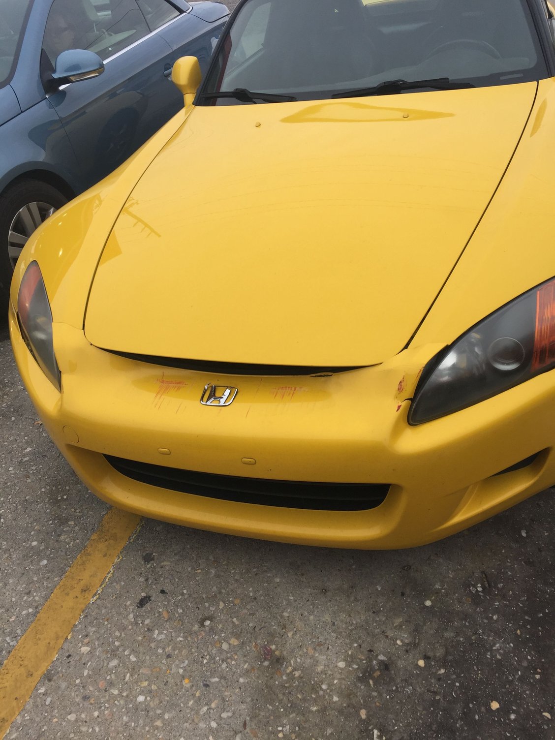

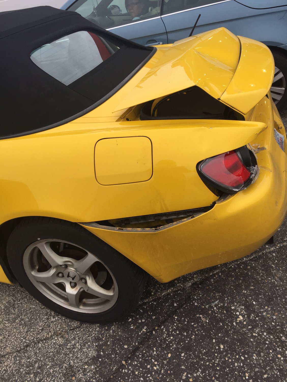

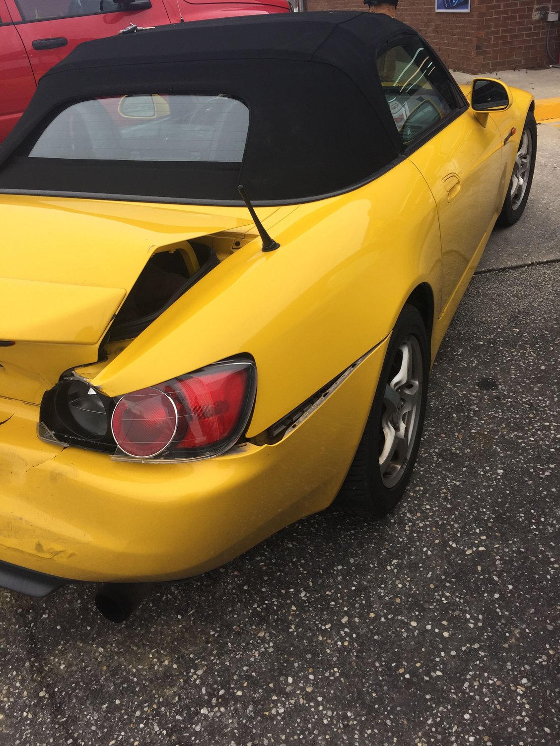

i really appreciate the help. I'll see if I can add pictures of the aftermath.
Old Dec 16, 2016 | 02:28 PM
Chong's Avatar
Joined: Sep 2014
Posts: 73
https://m.imgur.com/CncpK9X?r

You are correct. The S2000 must be towed on a flatbed, pretty sure this is even in our owner's manual... I'm not sure how likely there is to be damage done, hopefully it wasn't towed too far. Sorry about the accident looks like you have some quarter panel damage too

It was only towed like a mile. I knew I was right. God damn it. Now what am I going to do. Yeah the quarter panels are BARELY even damaged. That's what irritated me most. The left one has a 1 inch line creased dent. Right side has a dent the size of a quarter. And that's it.
Im really really really hoping the insurance company doesn't total it. If it gets totaled I might go beat up my friend and deal with the consequences. But he is gna get an asswhooping worth an s2k. Like imma beat the brakes off him.
