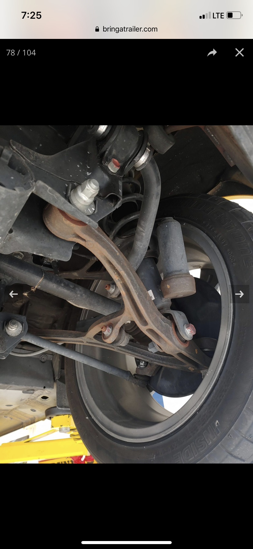

I currently have my car getting professionally detailed as I may sell it this spring. He has all the wheels off cleaning everything and offered to paint the control arms. The car came from South Carolina and I’ve never really drove it here. It’s not all that rusty there just isn’t much paint on them anymore. It’s basically what 99% of s2000s control arms look like now a days. Is it worth getting them painted? Not sure if it’d really help the value but I don’t want to hurt the value either. The picture is not of my car but they pretty much look the same way. What are your opinions?

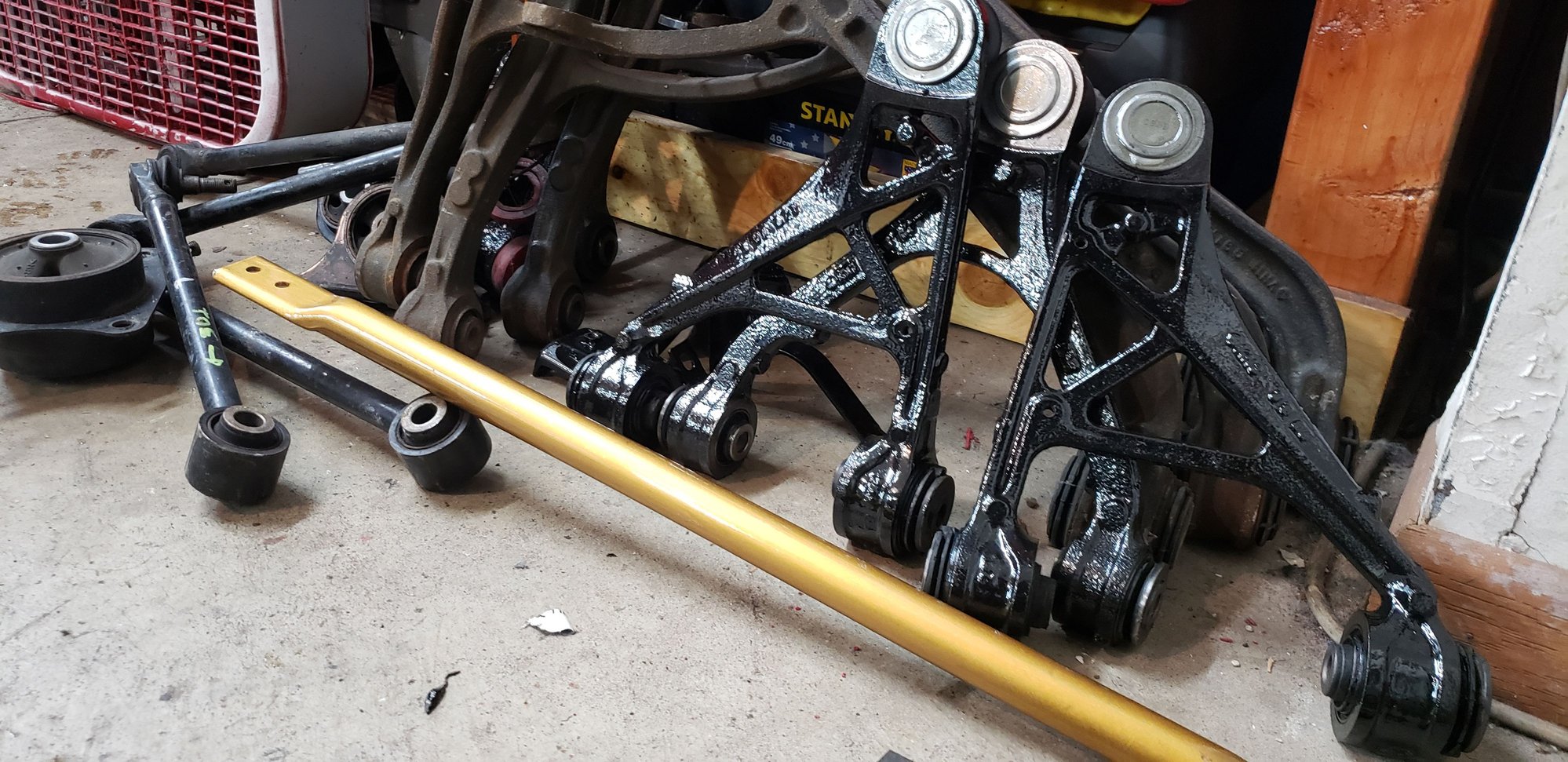

I use POR extensively. I would agree the best way is to remove, clean, and paint. Don't let someone loose on your car with spray paint. I would be mad if someone painted over the factory zinc plated hardware.
Here is a sample of semi gloss.
And a combination of high gloss black on the arms and clear gloss on the ball joint caps.
