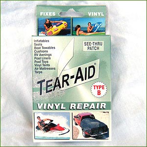

And, once it is shaved down, use this on the inside of the top
As long as the underside of the top is cleaned very well with rubbing alcohol and then rinsed and allowed to dry, and the instructins are followed, this stuff will stick for years and years. I had a couple spots on my top I thought looked a bit questionable, my patches have been on for 3-years

^that is great. I'm calling Camp-mor right now for it!
thanks a lot
