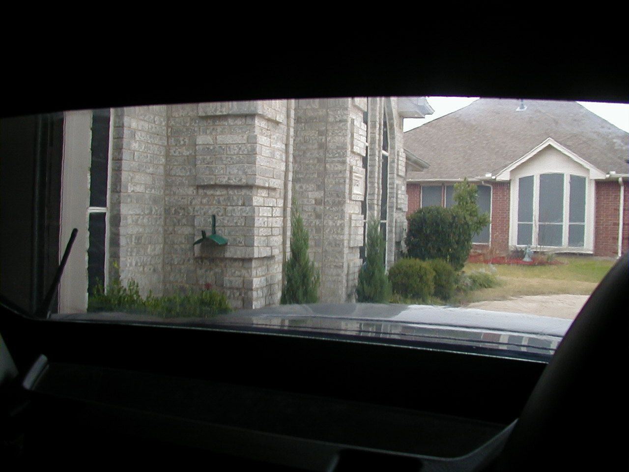

I had an ugly haze that wouldn't go away and minor scratches so I just tinted the window.

the visibility is still good. Just as if you tinted a glass rear window. You can get the tint at Walmart for 12 dollars. Just make sure you get static tint. Heres a view from the inside.
