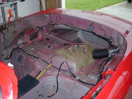

not worth taking out unless this is a track only car...... or you plan to keep the car forever..... resale would be killed if you didn't have it and 50-60lbs is not that big of a deal on a track if all you are doing is time trials or hpde's....... you would be better off monitoring your fuel and save most of the 50lbs right there.
It did not take me anything close to 2 hours to get my top out.... but I knew that the rollbars were coming out too, so I had an advantage.

Scot what are you doing to your car? I am with you on the top but I prefer it with the ht and i hate to add 48lbs. I can always put it back on. It s definetly not my daily driver.
